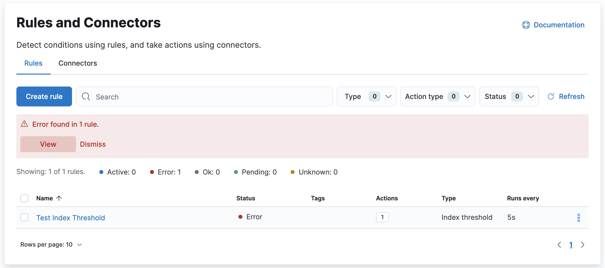

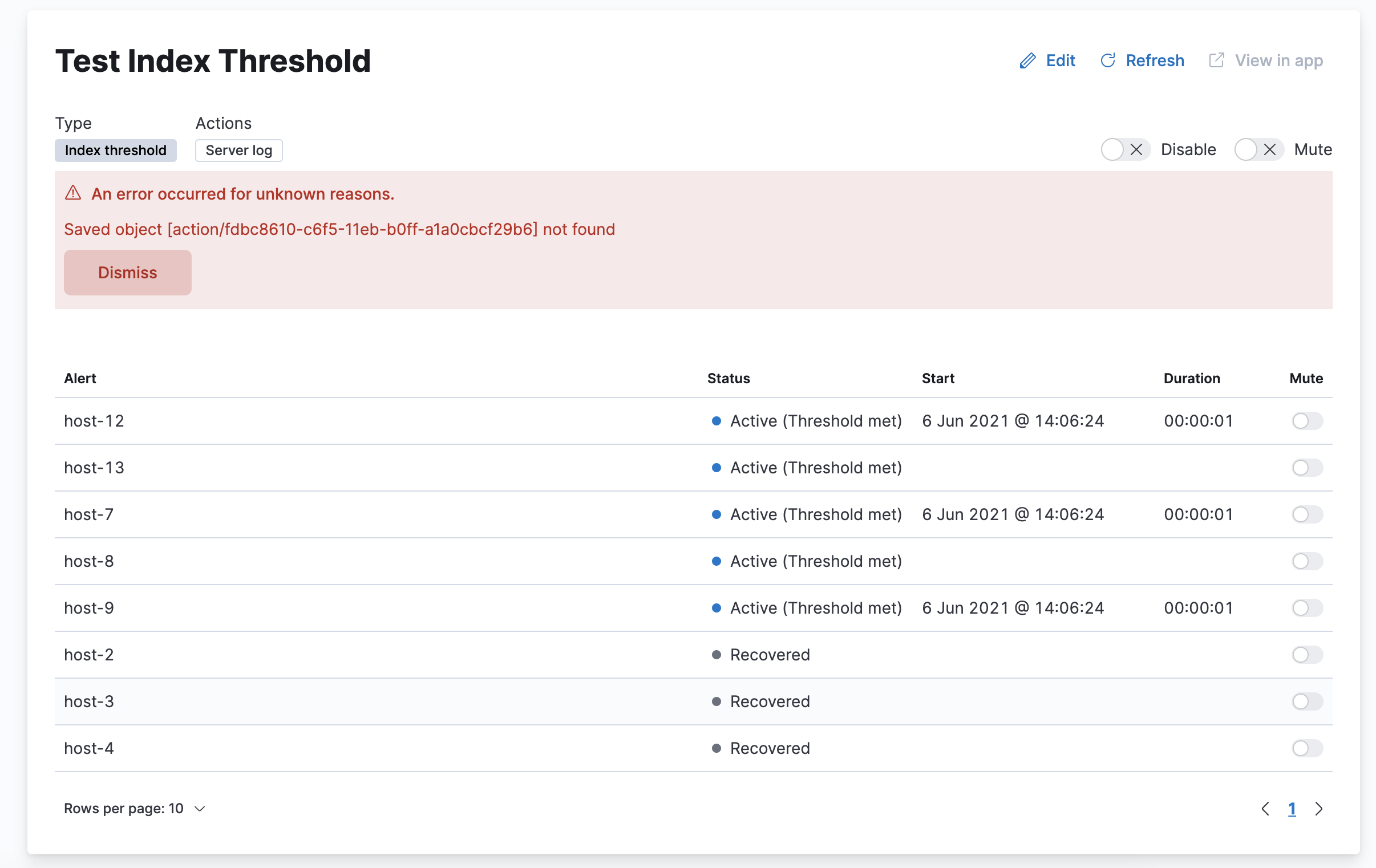

Look for error banners
editThe Rule Management and Rule Details pages contain an error banner, which helps to identify the errors for the rules:
