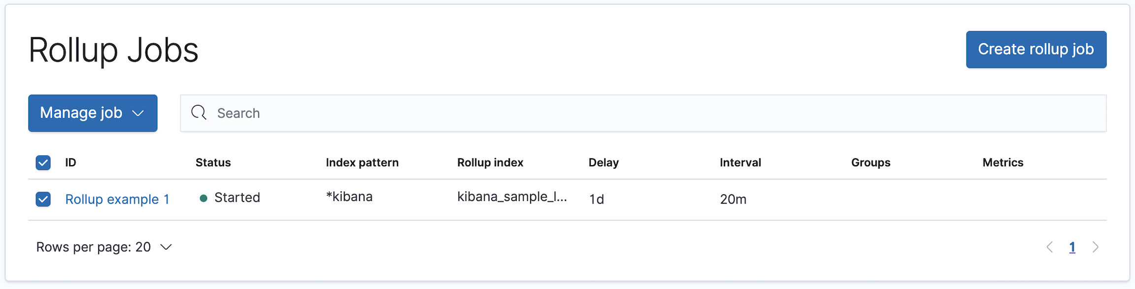

To get started, open the main menu, then click Stack Management > Rollup Jobs.
][List of currently active rollup jobs

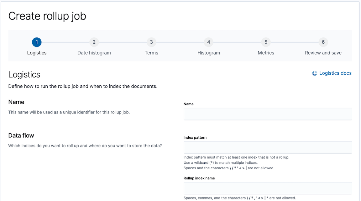

Kibana makes it easy for you to create a rollup job by walking you through the process. You fill in the name, data flow, and how often you want to roll up the data. Then you define a date histogram aggregation for the rollup job and optionally define terms, histogram, and metrics aggregations.
When defining the index pattern, you must enter a name that is different than the output rollup index. Otherwise, the job will attempt to capture the data in the rollup index. For example, if your index pattern is metricbeat-*, you can name your rollup index rollup-metricbeat, but not metricbeat-rollup.

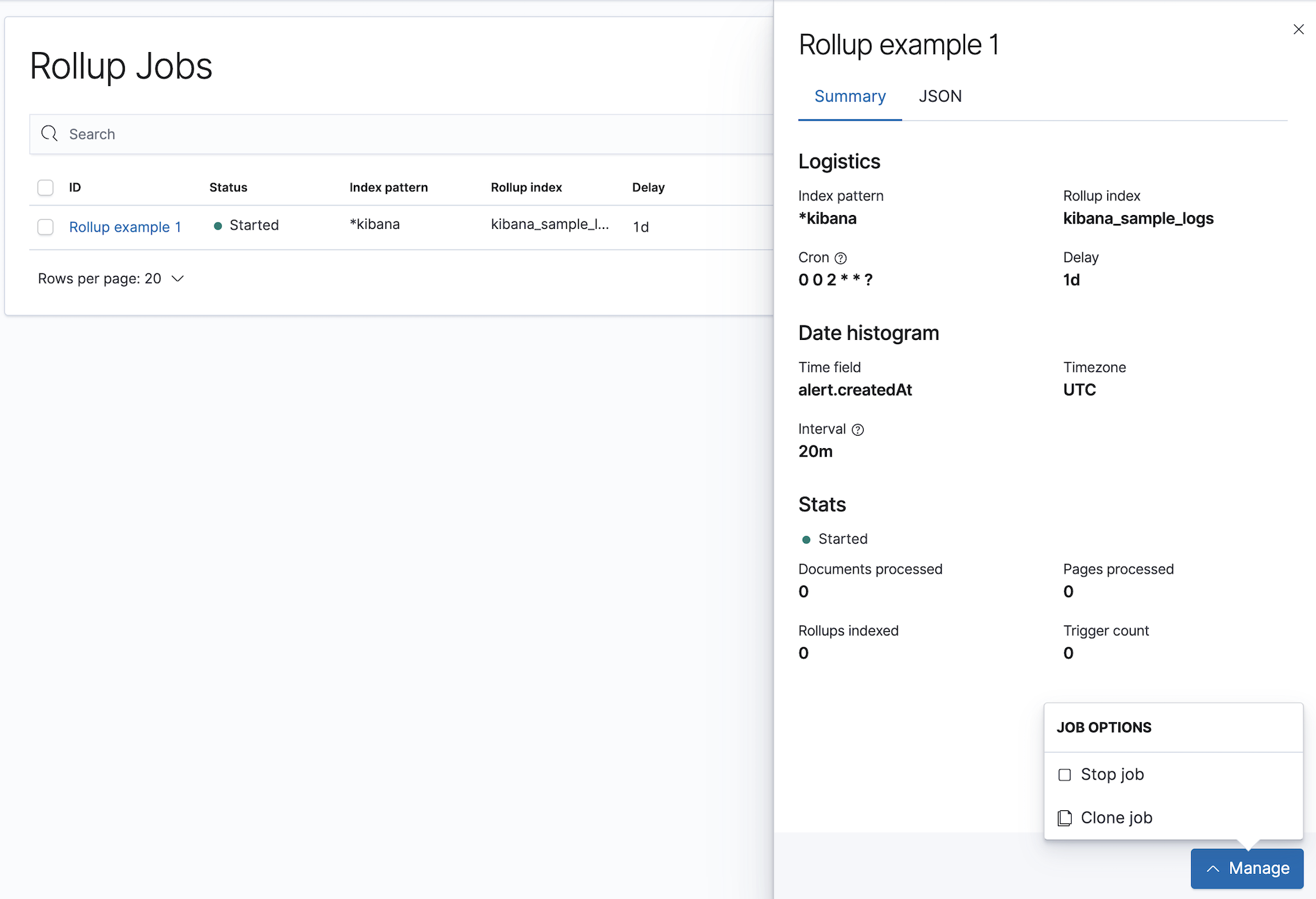

Once you’ve saved a rollup job, you’ll see it the Rollup Jobs overview page, where you can drill down for further investigation. The Manage menu enables you to start, stop, and delete the rollup job. You must first stop a rollup job before deleting it.
][Rollup job details
You can’t change a rollup job after you’ve created it. To select additional fields or redefine terms, you must delete the existing job, and then create a new one with the updated specifications. Be sure to use a different name for the new rollup job—reusing the same name can lead to problems with mismatched job configurations. You can read more at rollup job configuration.

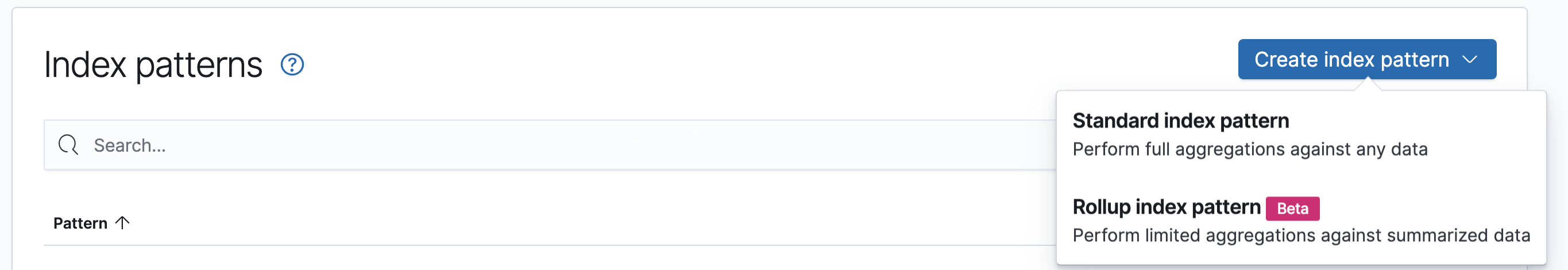

  1. Open the main menu, then click Stack Management > Index Patterns.
  2. Click Create index pattern, and select Rollup index pattern from the dropdown.

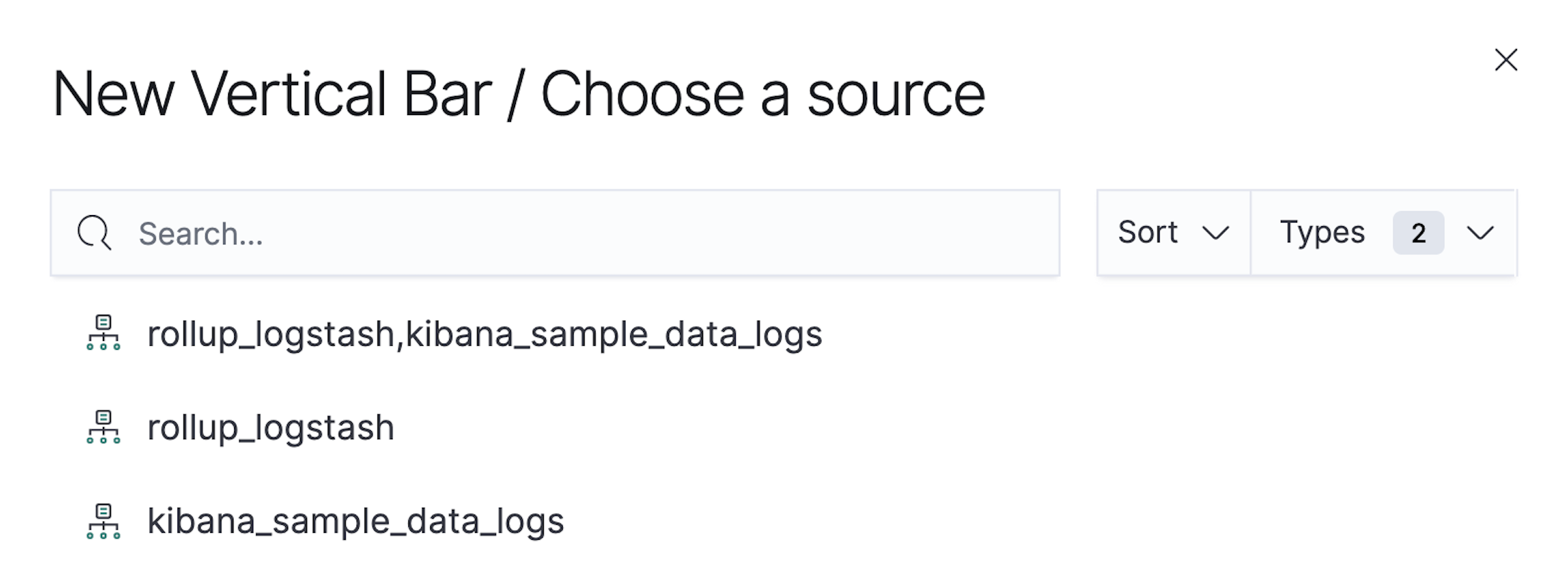

  4. Open the main menu, click Dashboard, then create and add a vertical bar chart.
  5. Choose rollup_logstash,kibana_sample_data_logs as your source to see both the raw and rolled up data.

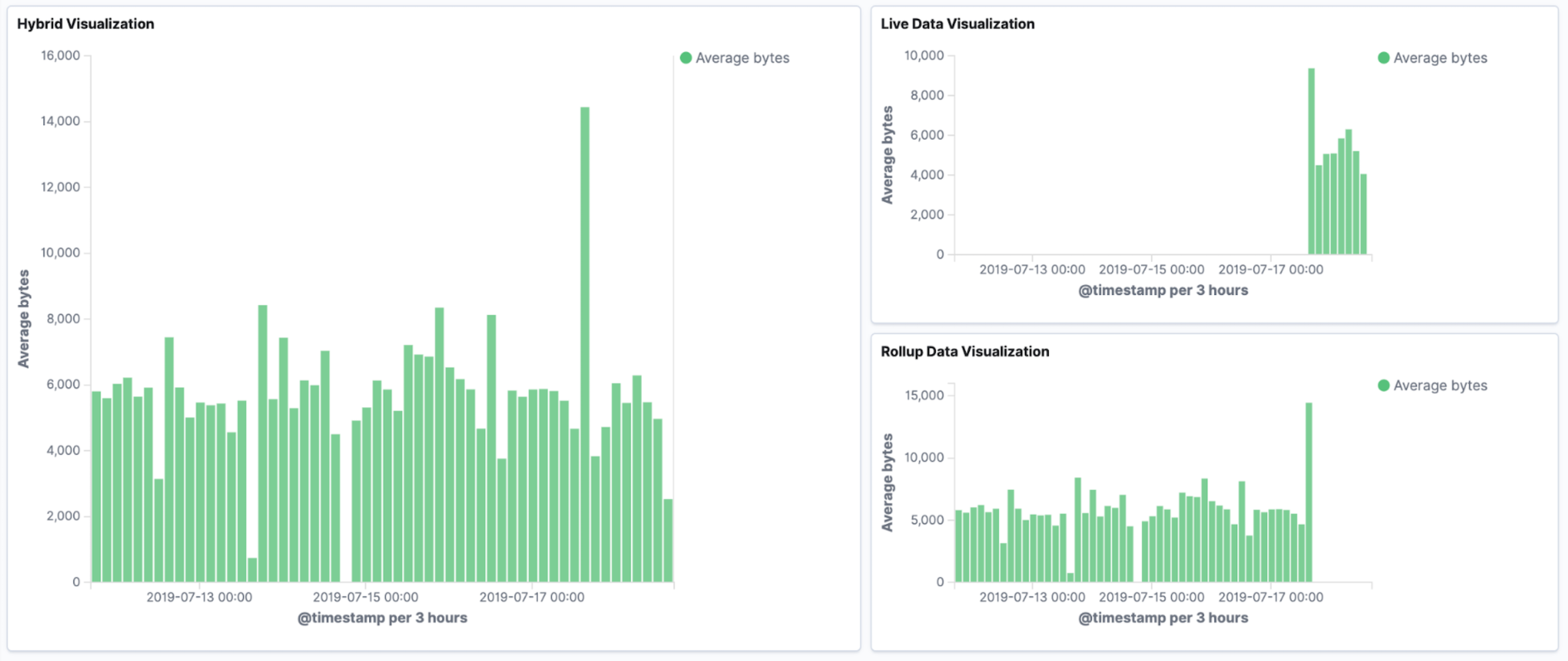

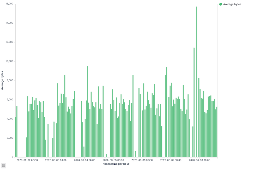

  6. Look at the data in your visualization.
    ][Visualization of rolled up data
  7. Optionally, create a dashboard that contains visualizations of the rolled up data, raw data, or both.
