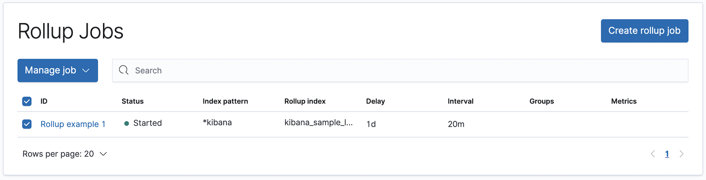

A rollup job is a periodic task that aggregates data from indices specified by an index pattern, and then rolls it into a new index. Rollup indices are a good way to compactly store months or years of historical data for use in visualizations and reports.
To get started, open the main menu, then click Stack Management > Rollup Jobs.
][List of currently active rollup jobs

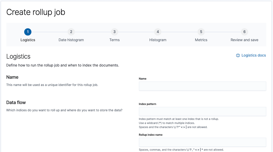

Kibana makes it easy for you to create a rollup job by walking you through the process. You fill in the name, data flow, and how often you want to roll up the data. Then you define a date histogram aggregation for the rollup job and optionally define terms, histogram, and metrics aggregations.
When defining the index pattern, you must enter a name that is different than the output rollup index. Otherwise, the job will attempt to capture the data in the rollup index. For example, if your index pattern is metricbeat-*, you can name your rollup index rollup-metricbeat, but not metricbeat-rollup.
][Wizard that walks you through creation of a rollup job

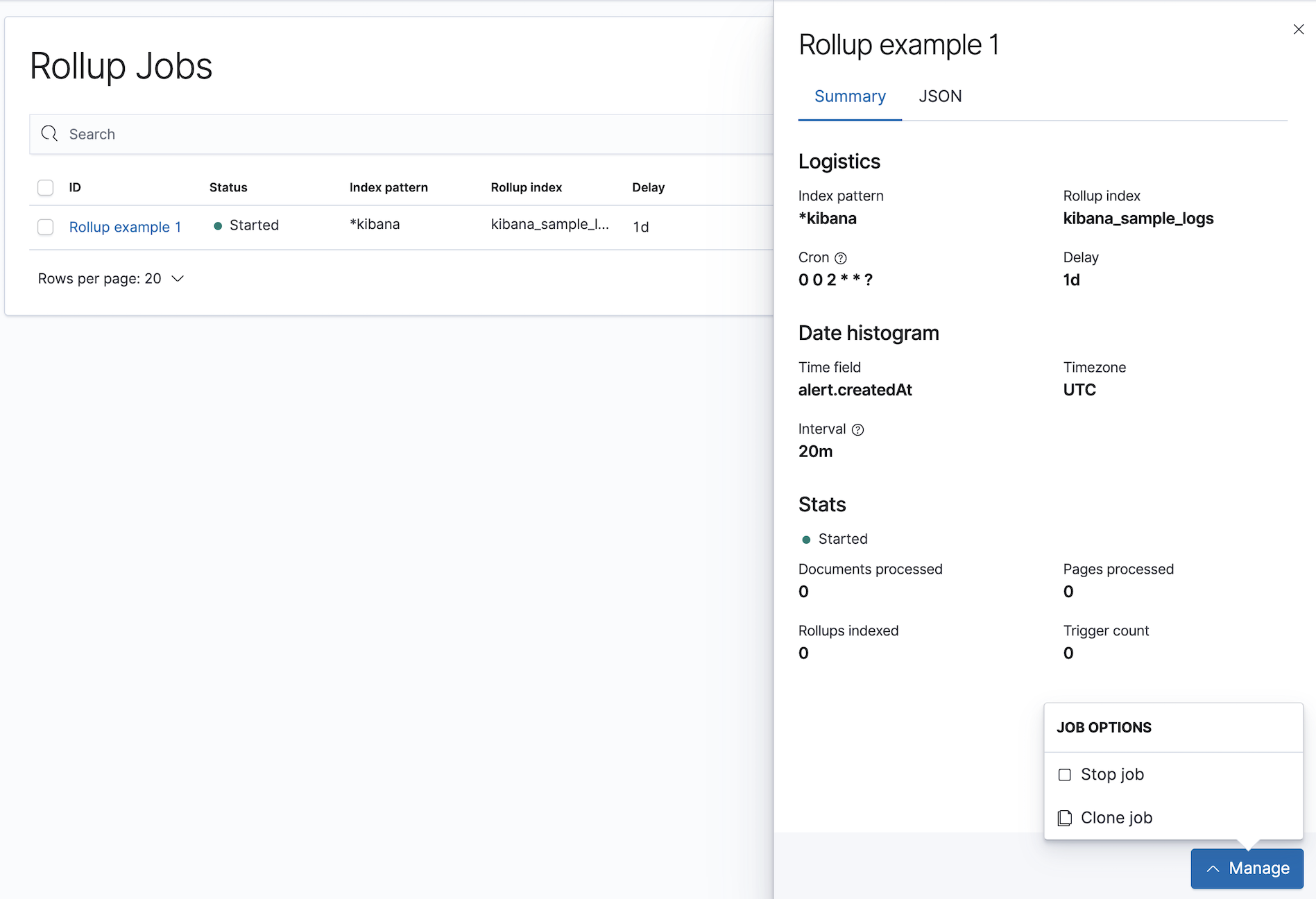

Once you’ve saved a rollup job, you’ll see it the Rollup Jobs overview page, where you can drill down for further investigation. The Manage menu enables you to start, stop, and delete the rollup job. You must first stop a rollup job before deleting it.
][Rollup job details

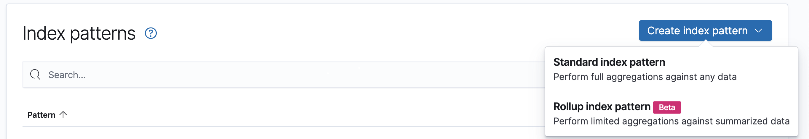

  2. Click Create index pattern, and select Rollup index pattern from the dropdown.
    ][Create rollup index pattern

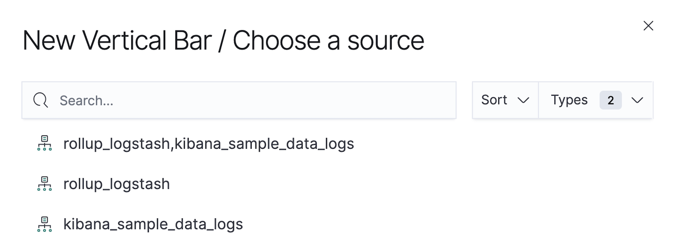

  4. Open the main menu, click Dashboard, then create and add a vertical bar chart.
  5. Choose rollup_logstash,kibana_sample_data_logs as your source to see both the raw and rolled up data.
    ][Create visualization of rolled up data

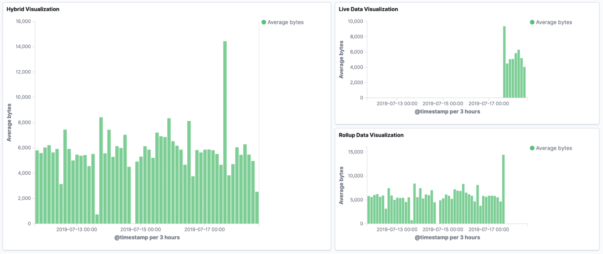

  6. Look at the data in your visualization.
    ][Visualization of rolled up data

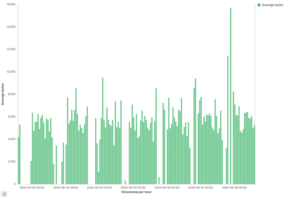

  7. Optionally, create a dashboard that contains visualizations of the rolled up data, raw data, or both.
    ][Dashboard with rolled up data
