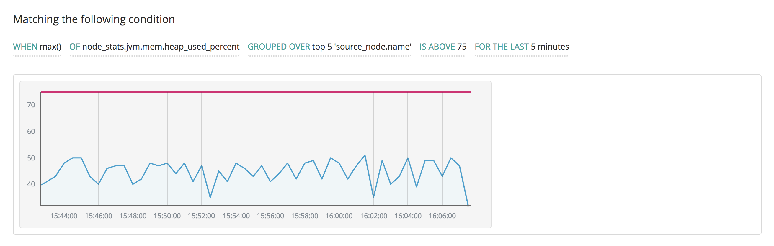

editHere, you can configure the condition that will cause alert to trigger. The UI is interactive and selecting the various elements within the expression will display a UI to change the values.

Here are some specifics of how the visualization works:
The time window that is used in the visualization is calculated by taking the duration defined in the expression and multiplying it by 5. So, if you select
FOR THE LAST 5 hours, the visualization will show data from the last 25 hours. - In the chart, you will see a blue line that represents the aggregated data. There is also a red line that represents the threshold value.
If you use the
termsaggregation to aggregate over a specific field, there will be multiple visualizations available and pagination controls will appear as shown below.
