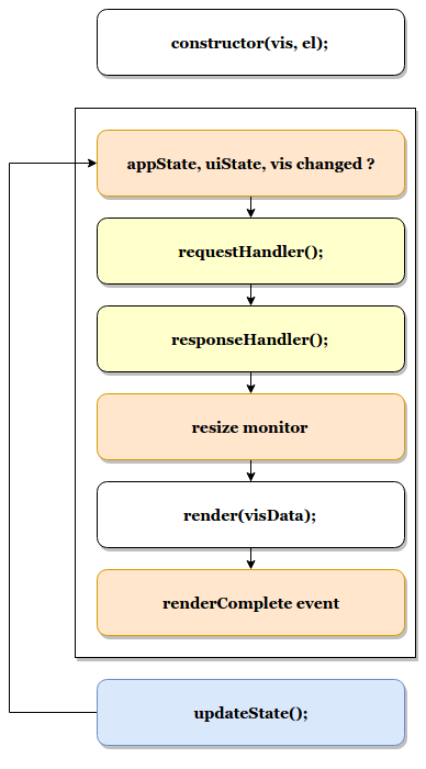

Main Flow
  • Your visualizations constructor will get called with vis object and the DOM-element to which it should render. At this point you should prepare everything for rendering, but not render yet
  • <visualize> component monitors appState, uiState and vis for changes
  • on changes the <visualize>-directive will call your requestHandler. Implementing a request handler is optional, as you might use one of the provided ones.
  • response from requestHandler will get passed to responseHandler. It should convert raw data to something that can be consumed by visualization. Implementing responseHandler is optional, as you might use of of the provided ones.
  • On new data from the responseHandler or on when the size of the surrounding DOM-element has changed, your visualization render-method gets called. It needs to return a promise which resolves once the visualization is done rendering.
  • the visualization should call vis.updateState() any time something has changed that requires to re-render or fetch new data.
