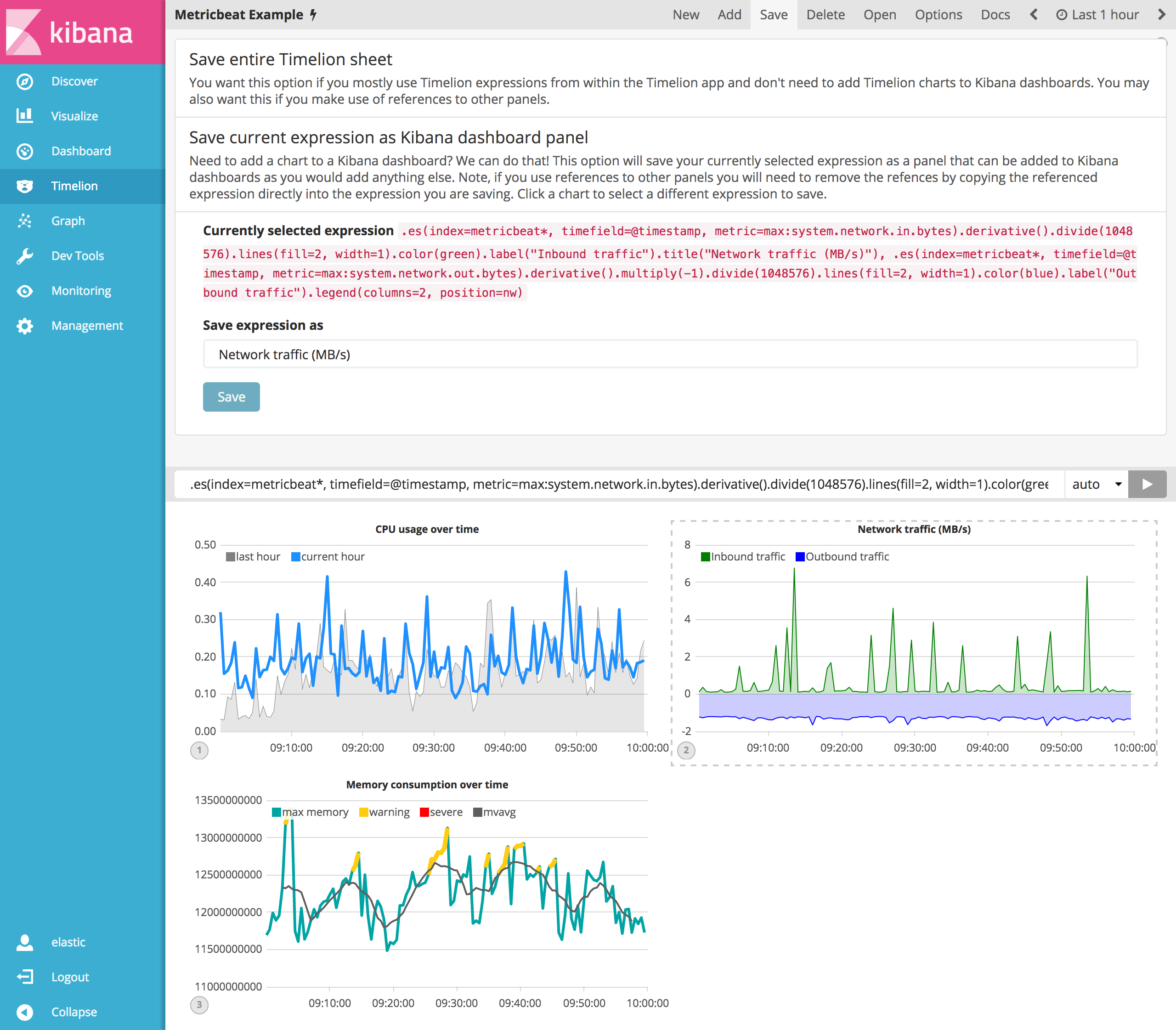

To save a Timelion visualization as a dashboard panel, follow the steps below.
- Select the visualization you’d like to add to one (or multiple) dashboards
Click the
Saveoption in the top menu -
Select
Save current expression as Kibana dashboard panel -
Name your panel and and click
Saveto save as a dashboard visualization

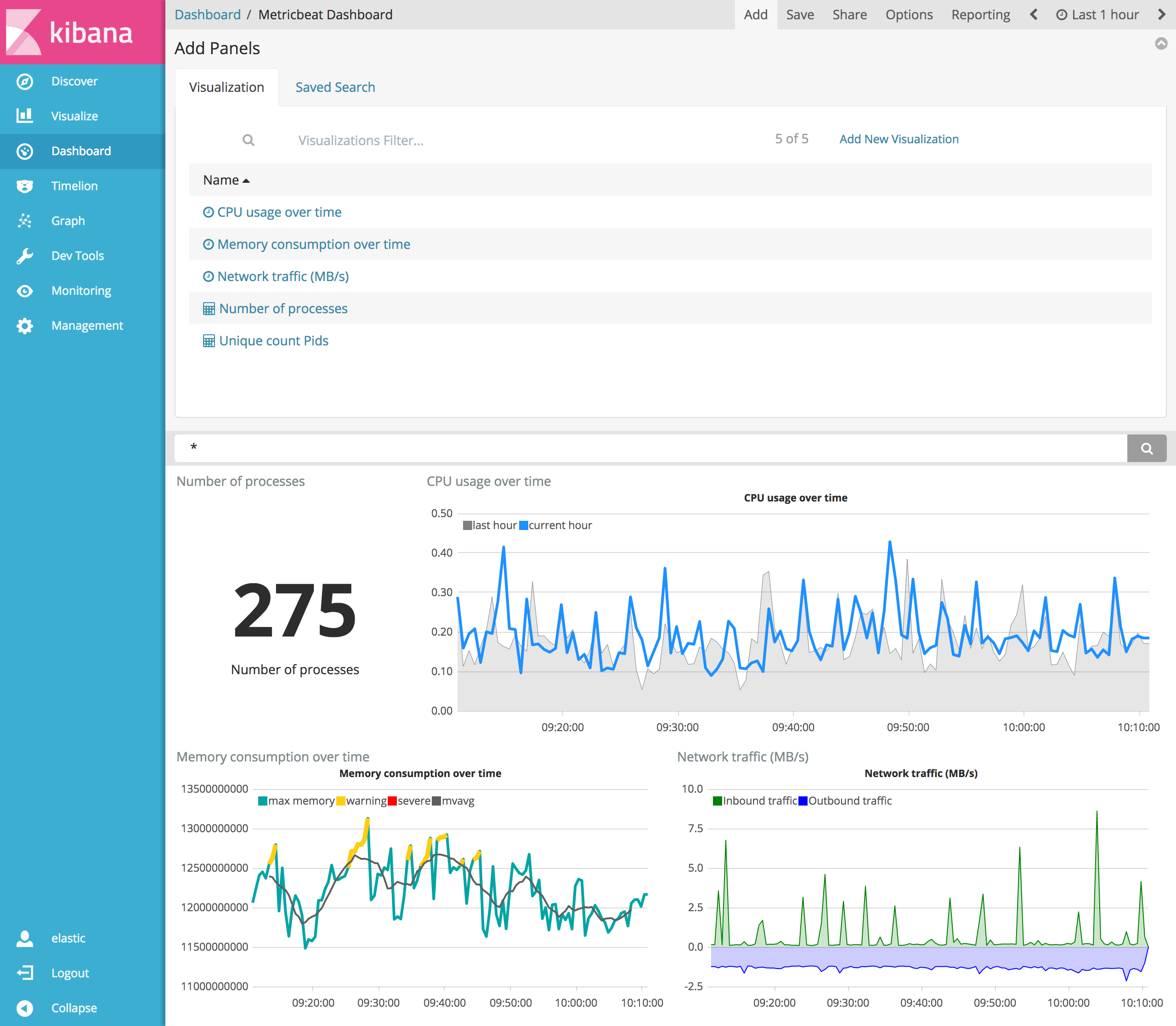

Now you can add this dashboard panel to any dashboard you’d like. This visualization will now be listed in the Visualize list. Go ahead and follow the same process for the rest of the visualizations you created.
Create a new dashboard or open an existing one to add the Timelion visualizations as you would any other visualization.
You can also create time series visualizations right from the Visualize app—just select the Timeseries visualization type and enter a Timelion expression in the expression field.
