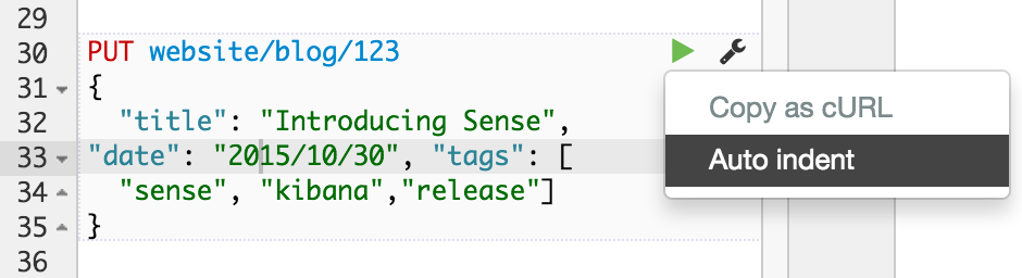

editConsole allows you to auto format messy requests. To do so, position the cursor on the request you would like to format and select Auto Indent from the action menu:
Figure 6. Auto Indent a request

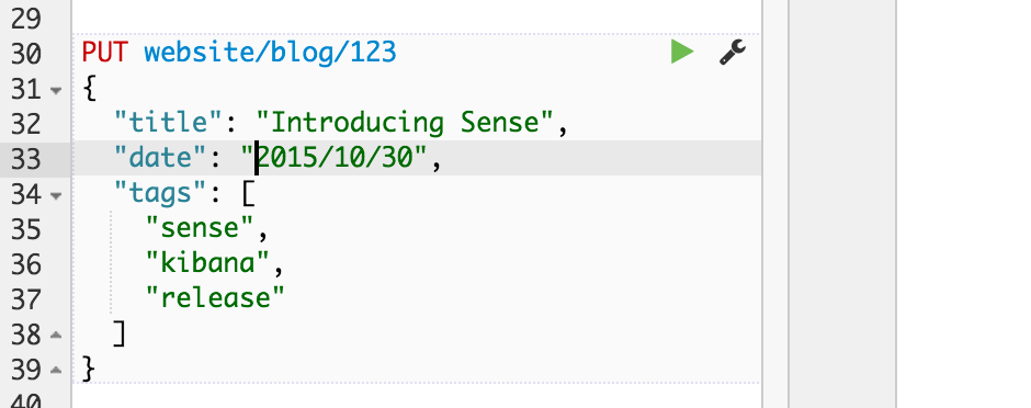

Console will adjust the JSON body of the request and it will now look like this:
Figure 7. A formatted request

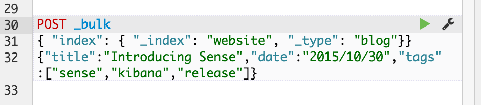

If you select Auto Indent on a request that is already perfectly formatted, Console will collapse the request body to a single line per document. This is very handy when working with Elasticsearch’s bulk APIs:
Figure 8. One doc per line
