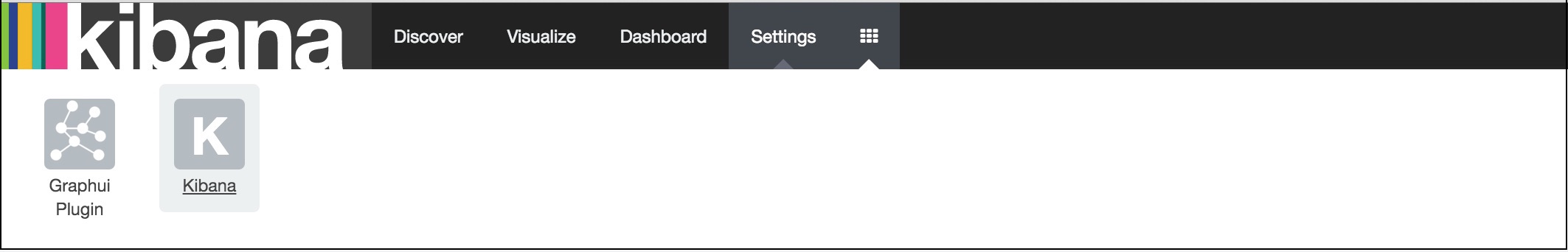

  4. Install the Graph UI plugin into Kibana by running bin/kibana plugin in your Kibana installation directory. If you need to install Kibana, see Getting Kibana Up and Running.
    bin/kibana plugin --install elasticsearch/graph/2.3.5
  5. Start Kibana by running bin/kibana.
  6. To verify your Graph installation, point your web browser at http://0.0.0.0:5601/ to open Kibana, click the App Switcher icon in the Kibana menu bar, and select Graph.
