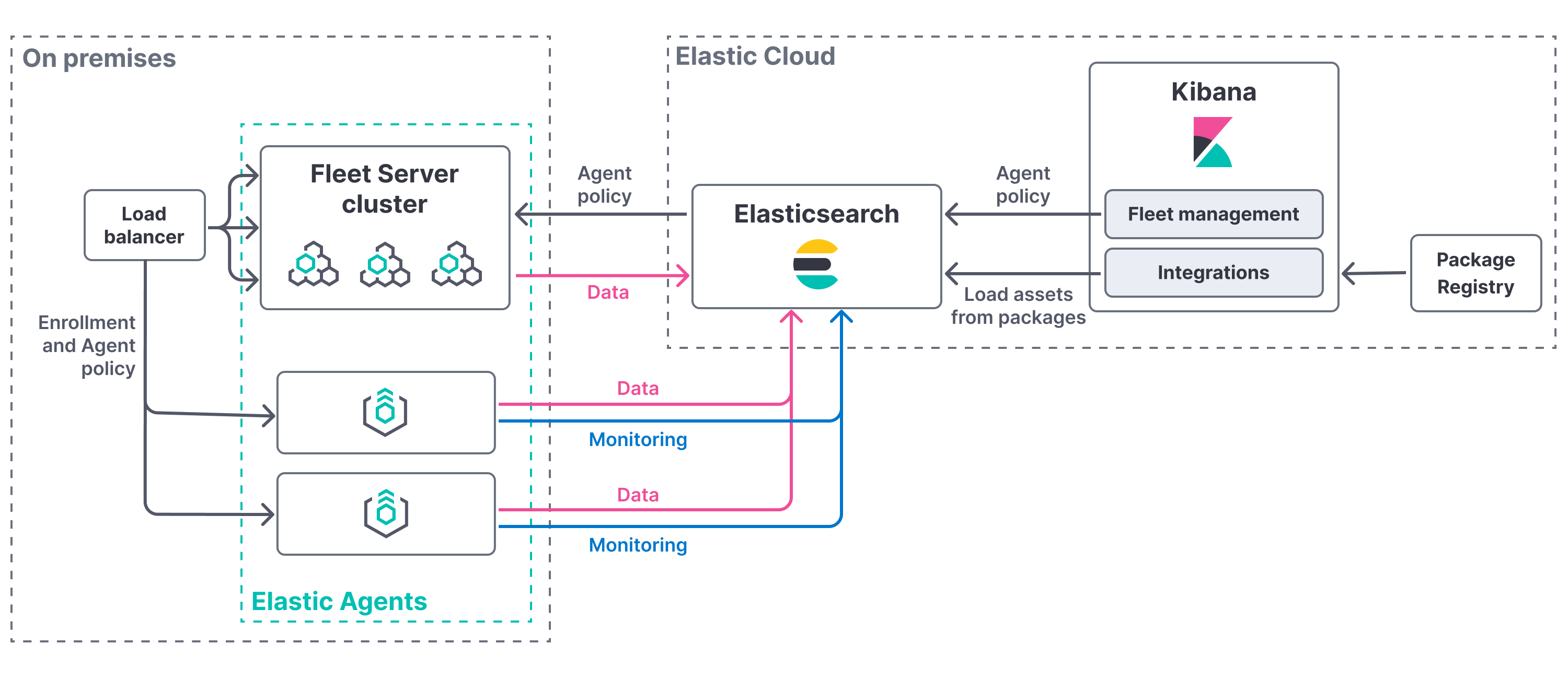

Another approach is to deploy a cluster of Fleet Servers on-premises and connect them back to Elastic Cloud with access to Elasticsearch and Kibana. In this deployment model, you are responsible for high-availability, fault-tolerance, and lifecycle management of Fleet Server.
This approach might be right for you if you would like to limit the control plane traffic out of your data center. For example, you might take this approach if you are a managed service provider or a larger enterprise that segregates its networks.
This approach might not be right for you if you don’t want to manage the life cycle of an extra compute resource in your environment for Fleet Server to reside on.
![Fleet Server on-premise and Elasticsearch on Cloud deployment model](images/fleet-server-on-prem-es-cloud.png)
