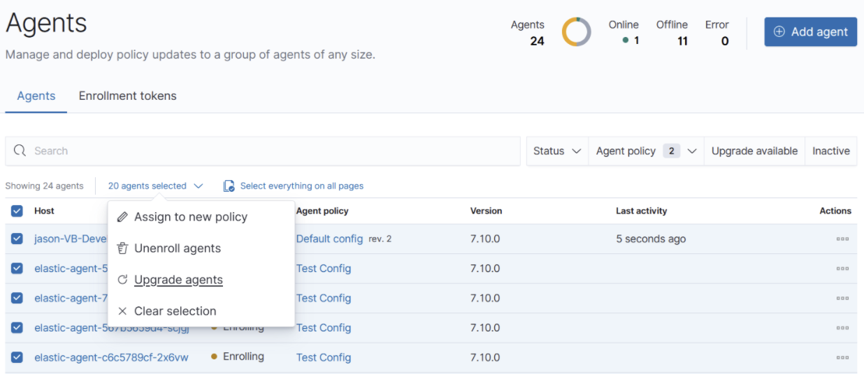

  4. To upgrade multiple agents, bulk select the agents and click Upgrade agents.
    Upgrade menu for bulk upgrade in Fleet

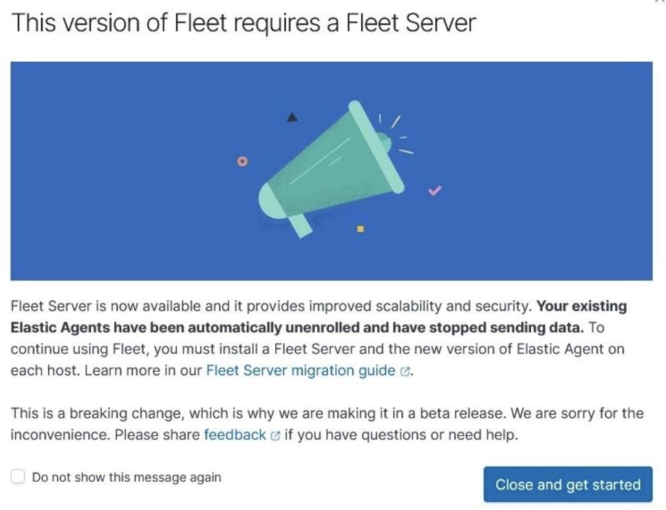

  1. Log in to Kibana and go to Management > Fleet, and click the Agents tab.
  2. The following message is displayed. Please note that your Elastic Agents have now been unenrolled and have stopped sending data.
    Select Do not show this message again, and then click Close and get started.

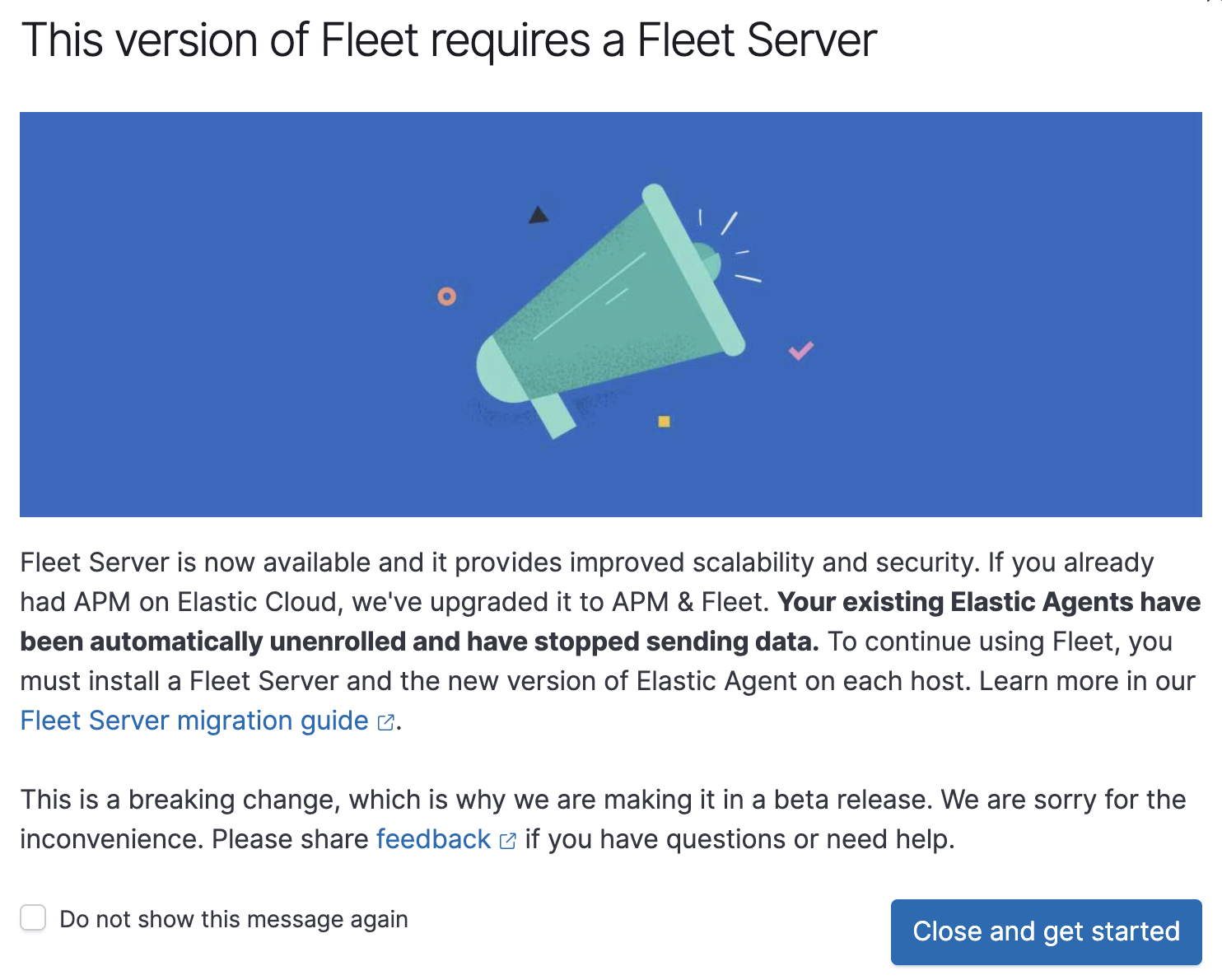

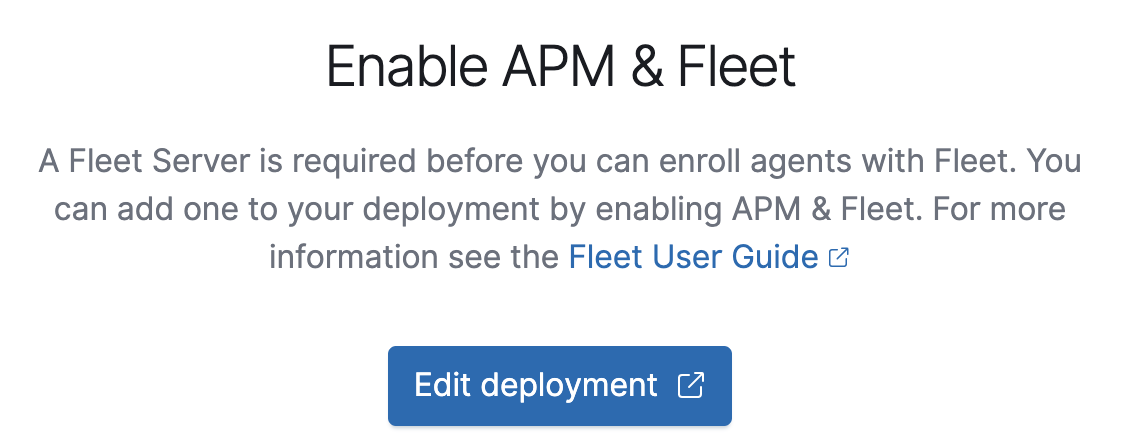

    If your previous deployment did not include an APM node, you are prompted to enable APM & Fleet, required for using Fleet Server.
    Click Edit deployment and add an APM & Fleet node to your deployment.
