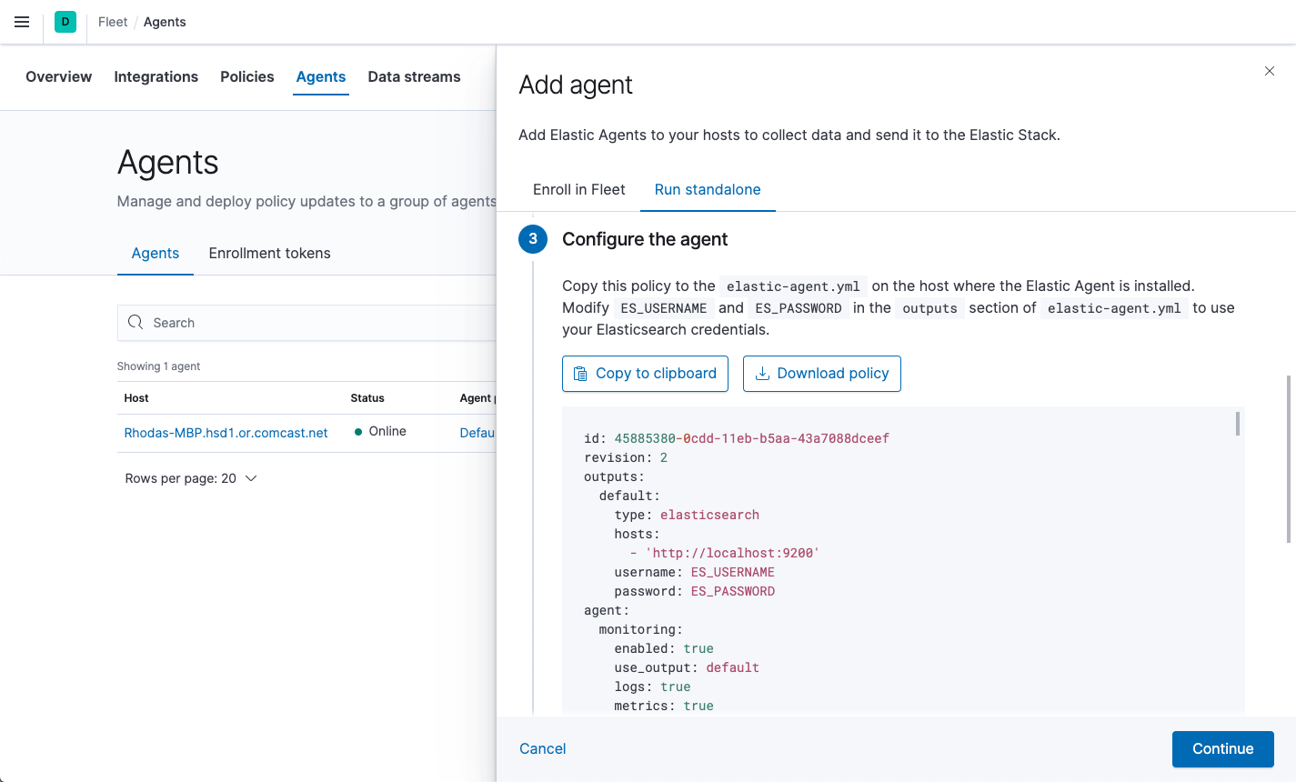

To save time, use Fleet in Kibana to generate your standalone configuration:
- Log in to Kibana and go to Management > Fleet.
- On the Agents tab, click Add agent, and look at the deployment instructions under Run standalone.

- Back in Fleet, under Choose an agent policy, select a policy to use for the agent. The default policy includes a system integration for collecting logs and metrics from the host system.
Under Configure the agent, copy or download the policy. Copy this policy to the
elastic-agent.ymlon the host where the Elastic Agent is extracted.
The policy generated by Fleet already contains the correct Elasticsearch address and port for your setup. If you run everything locally, the address is
127.0.0.1:9200. If you use our hosted Elasticsearch Service on Elastic Cloud, you can see the Elasticsearch endpoint URL by copying it from the overview page of your deployment. -
Modify
ES_USERNAMEandES_PASSWORDin the outputs section ofelastic-agent.ymlto use your Elasticsearch credentials. For example:[...] outputs: default: type: elasticsearch hosts: - 'http://localhost:9200' username: ES_USERNAME password: ES_PASSWORD [...]To create a role that has the privileges needed by the Elastic Agent user, go to Management > Dev Tools in Kibana and run:
POST /_security/role/standalone_agent { "cluster": ["monitor"], "indices": [ { "names": ["logs-*", "metrics-*", "events-*", ".ds-logs-*", ".ds-metrics-*", ".ds-events-*"], "privileges": ["write", "create_index", "indices:admin/auto_create"] } ] }Make sure you assign this role to the user in Kibana.
