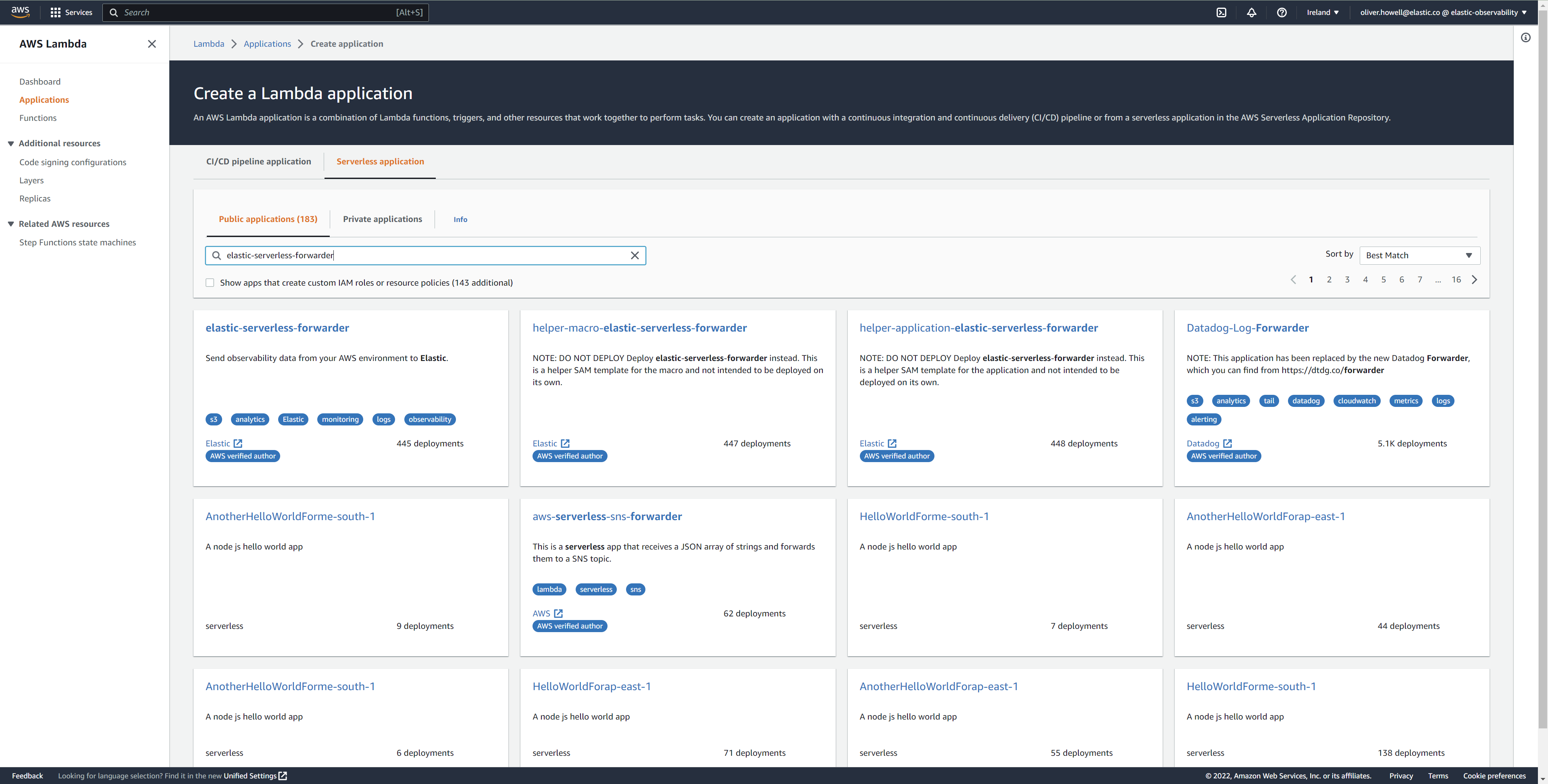

Deploy using AWS Consoleedit
  1. Log in to AWS console and open Lambda.
  2. Click Applications and then Create application.
  3. Click Serverless application and search for elastic-serverless-forwarder.
  4. Select elastic-serverless-forwarder from the search results (ignoring any application beginning helper-).
    Create Elastic Serverless Forwarder Lambda function within SAR
  5. Complete the Application settings according to Define deployment parameters.
  6. After your settings have been added, click Deploy.
  7. On the Applications page for serverlessrepo-elastic-serverless-forwarder, click Deployments.
  8. Refresh the Deployment history until you see the Create complete status update. It should take around 5 minutes to deploy — if the deployment fails for any reason, the create events will be rolled back and you will be able to see an explanation for which event failed.
