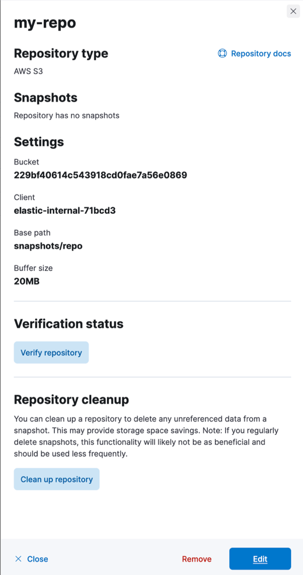

  2. Get the details for the repository we’ll recreate later by clicking on the repository name in the repositories table and making note of all the repository configurations that are displayed on the repository details page (we’ll use them when we recreate the repository). Close the details page using the link at the bottom left of the page.

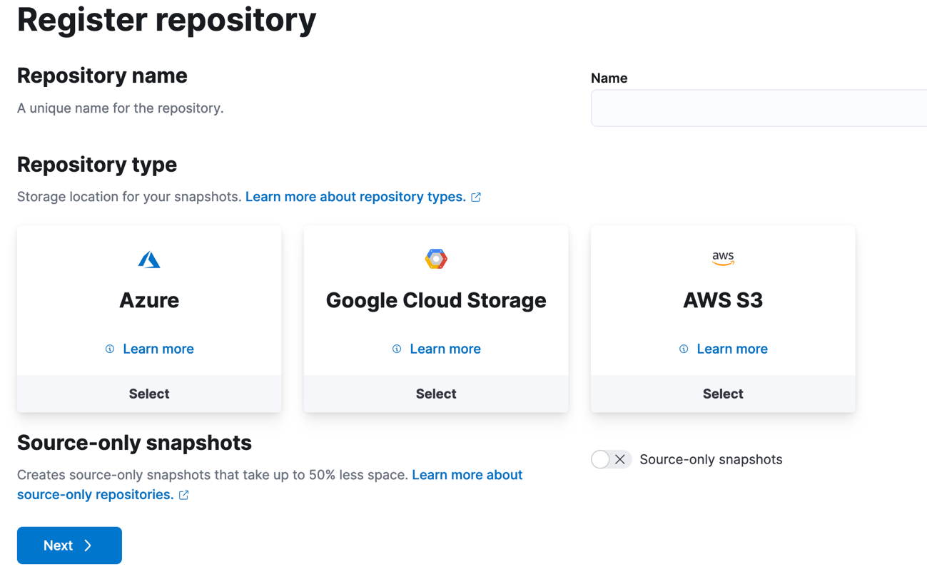

  5. Fill in the repository name, select the type and click "Next".

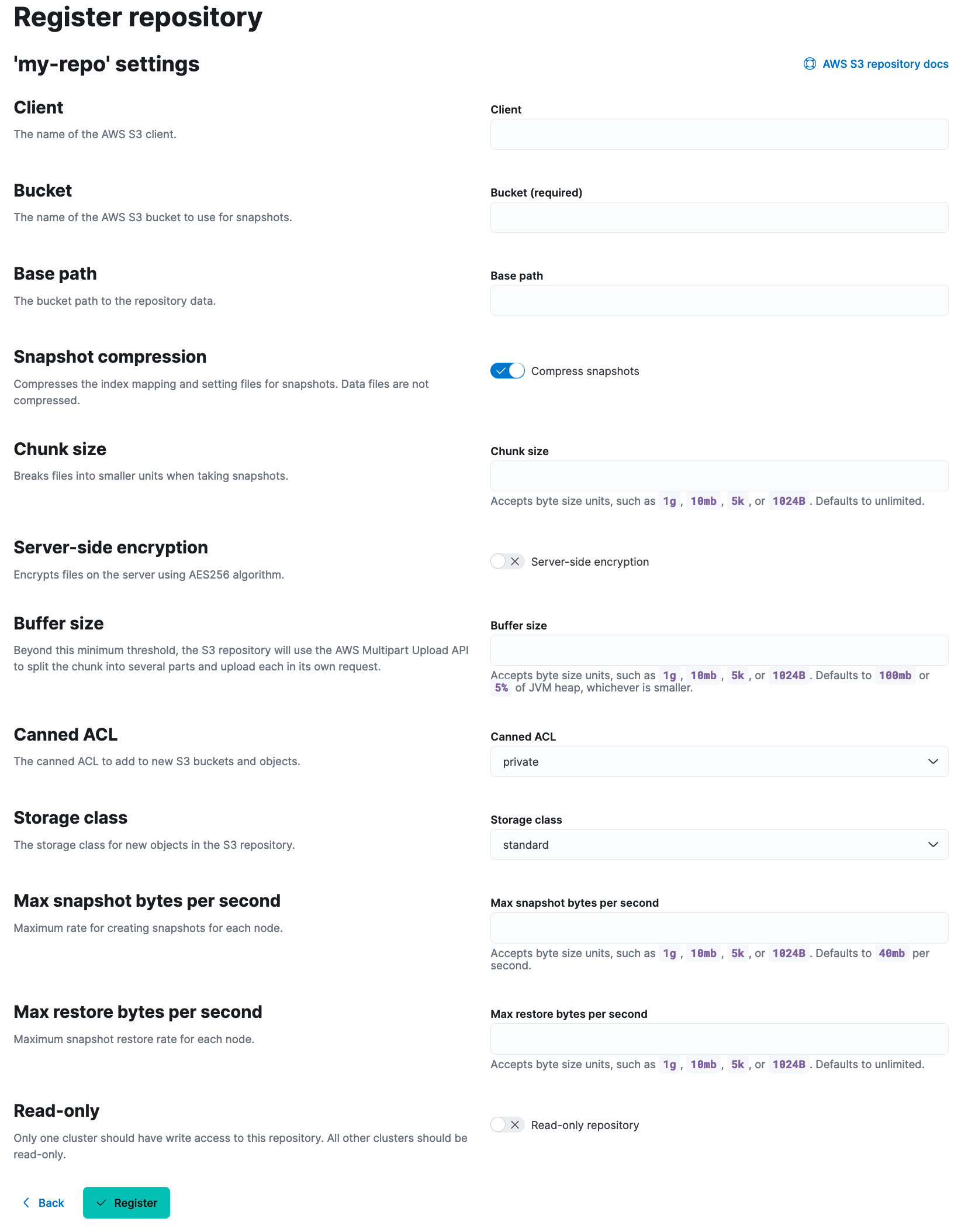

  6. Fill in the repository details (client, bucket, base path etc) with the values you noted down before deleting the repository and click the "Register" button at the bottom.
