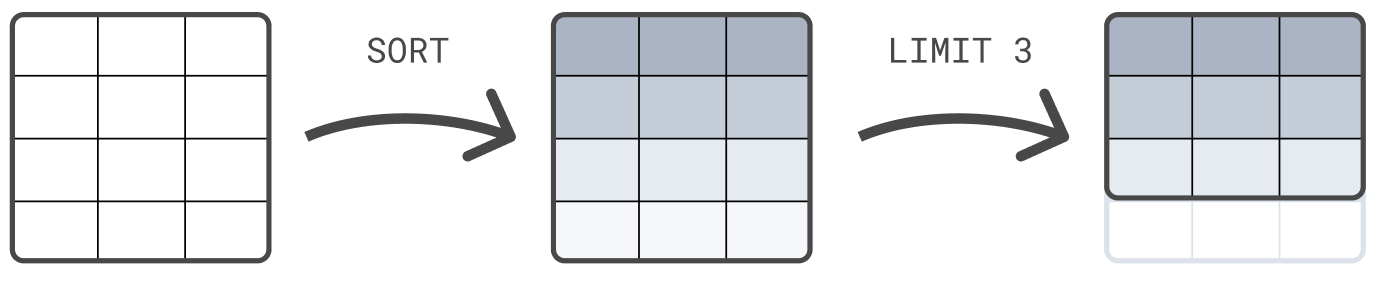

Chain processing commands
editYou can chain processing commands, separated by a pipe character: |. Each
processing command works on the output table of the previous command. The result
of a query is the table produced by the final processing command.
The following example first sorts the table on @timestamp, and next limits the
result set to 3 rows:
FROM sample_data | SORT @timestamp DESC | LIMIT 3
The order of processing commands is important. First limiting the result set to 3 rows before sorting those 3 rows would most likely return a result that is different than this example, where the sorting comes before the limit.
