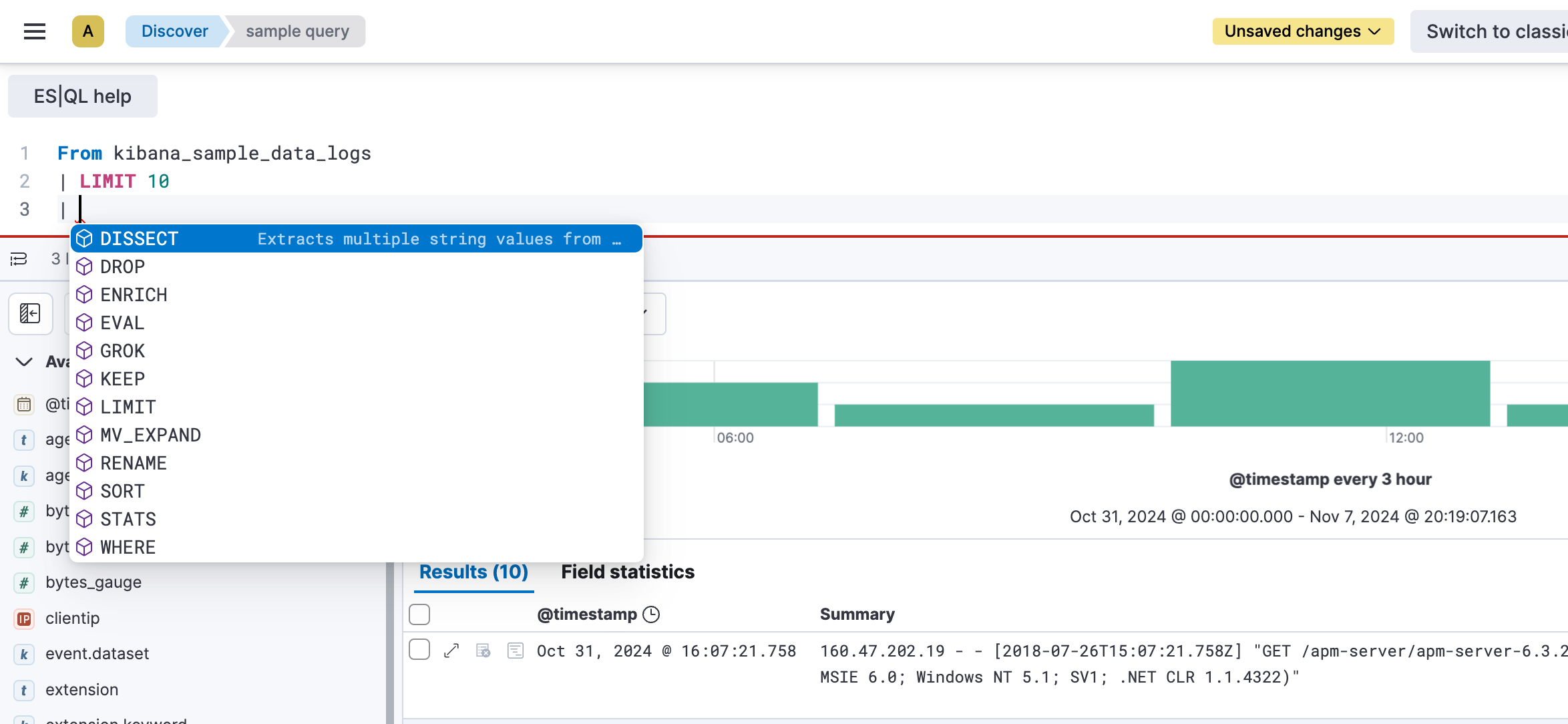

To get started with ES|QL in Discover, open the main menu and select Discover. Next, select Try ES|QL from the application menu bar.
Adjust the time filter so it includes the timestamps in the sample data (October 23rd, 2023).
After switching to ES|QL mode, the query bar shows a sample query. You can replace this query with the queries in this getting started guide.
To make it easier to write queries, auto-complete offers suggestions with possible commands and functions:
You can adjust the editor’s height by dragging its bottom border to your liking.
