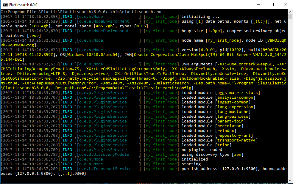

Running Elasticsearch from the command lineedit
Once installed, Elasticsearch can be started from the command line, if not installed as a service and configured to start when installation completes, as follows:
.\bin\elasticsearch.exe
The command line terminal will display output similar to the following:
elasticsearch exe
By default, Elasticsearch runs in the foreground, prints its logs to STDOUT in addition to the <cluster name>.log file within LOGSDIRECTORY, and can be stopped by pressing Ctrl-C.
