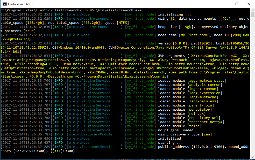

If you installed Elasticsearch on Windows using the .msi package, you can start Elasticsearch from the command line. If you want it to start automatically at boot time without any user interaction, install Elasticsearch as a Windows service.
Running Elasticsearch from the command lineedit
Once installed, Elasticsearch can be started from the command line, if not installed as a service and configured to start when installation completes, as follows:
.\bin\elasticsearch.exe
The command line terminal will display output similar to the following:
images/msi_installer/elasticsearch_exe.png
By default, Elasticsearch runs in the foreground, prints its logs to STDOUT in addition to the <cluster name>.log file within LOGSDIRECTORY, and can be stopped by pressing Ctrl-C.
