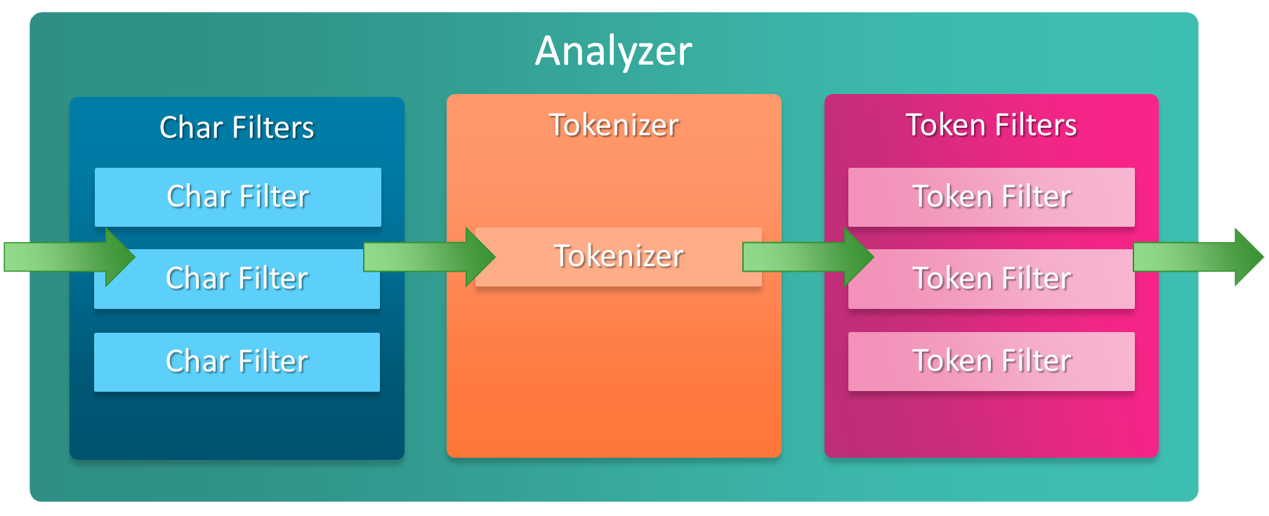

The analysis chain
An analyzer is built of three components:
  • 0 or more character filters
  • exactly 1 tokenizer
  • 0 or more token filters
analysis chain
Check out the Elasticsearch documentation on the Anatomy of an analyzer to understand more.
