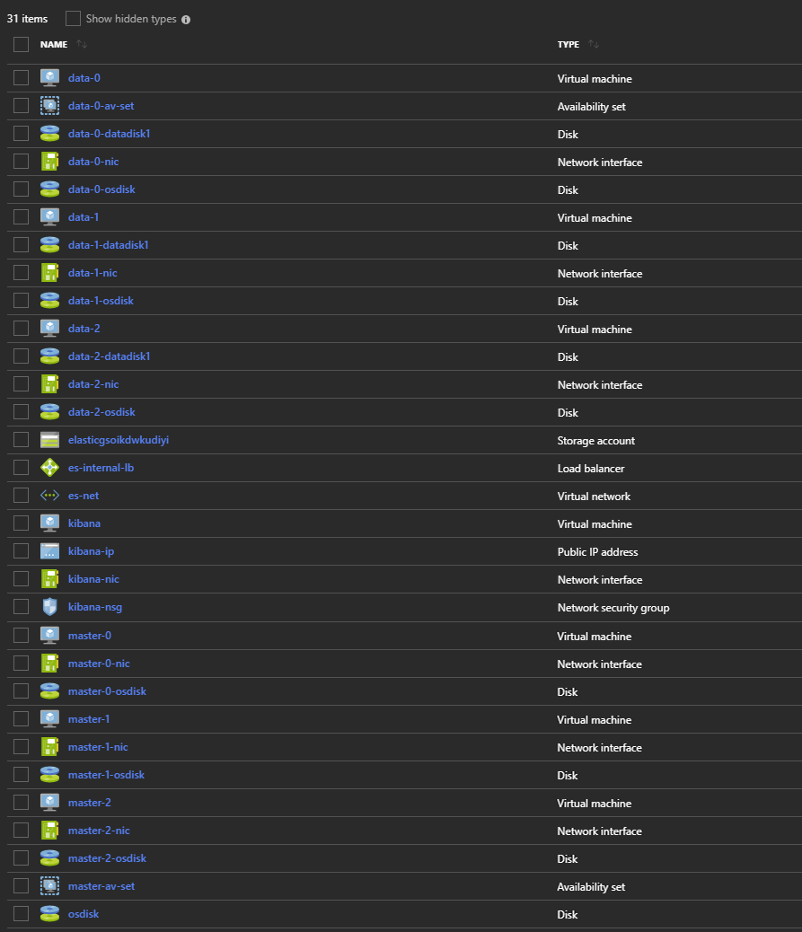

    A screenshot of the resources deployed by default:
    marketplace default resources
