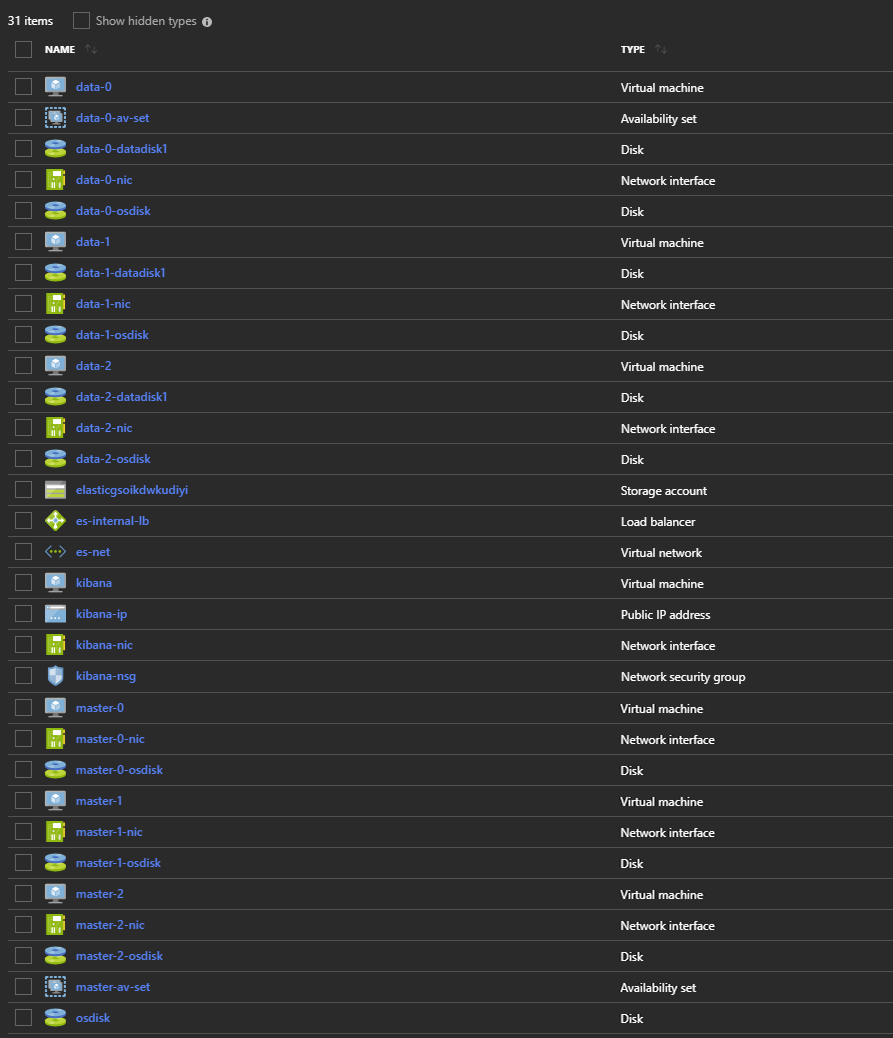

The default configuration of the Marketplace deploys the following resources:
- 1 virtual network
- 3 dedicated master node Standard D1 SKU VMs running Ubuntu 16.04 with OS disks and network interfaces
- 1 availability set for master nodes
- 3 data node Standard DS1 v2 SKU VMs running Ubuntu 16.04 with OS disks, network interfaces and one 1024Gb managed disk per data node
- 1 availability set for data nodes
- 1 Kibana Standard D1 SKU VM running Ubuntu 16.04 with OS disk, network interface, network security group and public IP address
1 internal load balancer
A screenshot of the resources deployed by default:
