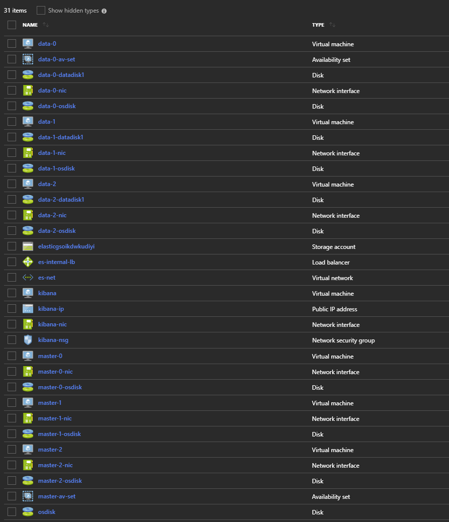

What resources does the Marketplace deploy?
The default configuration of the Marketplace deploys the following resources:
  • 1 virtual network
  • 3 dedicated master node Standard D1 SKU VMs running Ubuntu 16.04 with OS disks and network interfaces
  • 1 availability set for master nodes
  • 3 data node Standard DS1 v2 SKU VMs running Ubuntu 16.04 with OS disks, network interfaces and one 1024Gb managed disk per data node
  • 1 availability set for data nodes
  • 1 Kibana Standard D1 SKU VM running Ubuntu 16.04 with OS disk, network interface, network security group and public IP address
  • 1 internal load balancer
    A screenshot of the resources deployed by default:
    marketplace default resources
