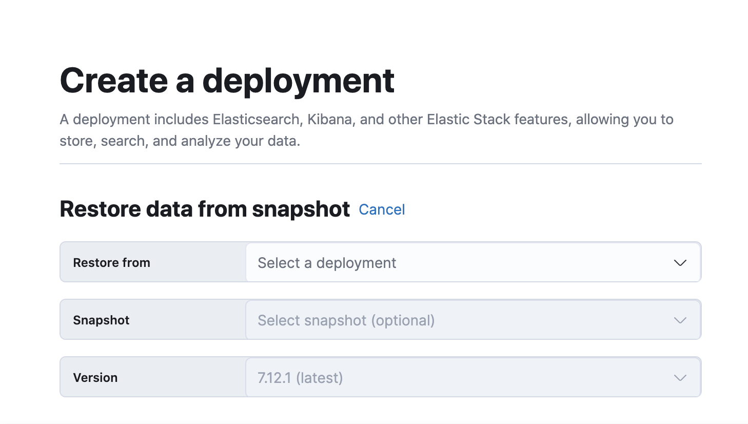

Elastic Cloud Hosted
When you create a deployment, a default repository called found-snapshots is automatically added to the Elasticsearch cluster. This repository is specific to that cluster: the cluster ID is part of the repository’s base_path, such as /snapshots/[cluster-id].
Do not disable or delete the default cloud-snapshot-policy SLM policy, and do not change the default found-snapshots repository defined in that policy. These actions are not supported.
The default policy and repository are used when:
- Creating a new deployment from a snapshot
- Restoring a snapshot to a different deployment
- Taking automated snapshots in case of deployment changes
In Elastic Cloud Hosted, a snapshot in the default found-snapshots repository can be restored to another deployment only when both deployments are in the same organization and the same region. To move data across different regions or organizations using a custom repository, refer to Restrictions and known problems > Migrate a deployment to another organization or region.
For API-driven deployment linking of platform-managed snapshots, refer to Manage snapshot repositories in Elastic Cloud Hosted.
You can customize the snapshot retention settings in that policy to adjust them to your needs.
To use a custom snapshot repository, register a new snapshot repository and create another SLM policy.
