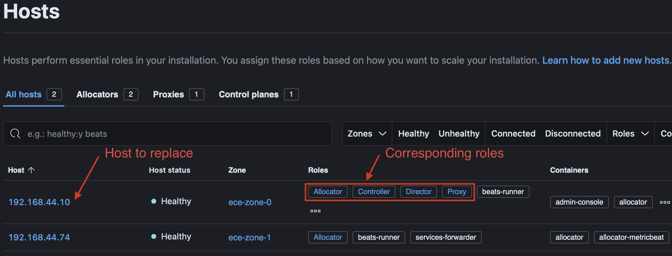

  5. Identify the host you want to replace with a podman-based host and copy the associated roles.
    Example 1 You want to migrate the docker host 192.168.44.74 with the role Allocator to a podman host. Copy the role allocator.
    Migrate Allocator
    Example 2 You want to migrate the docker host 192.168.44.10 with the roles Allocator, Controller, Director, and Proxy to a podman host. Copy the roles allocator, coordinator, director, proxy.
    Migrate Allocator

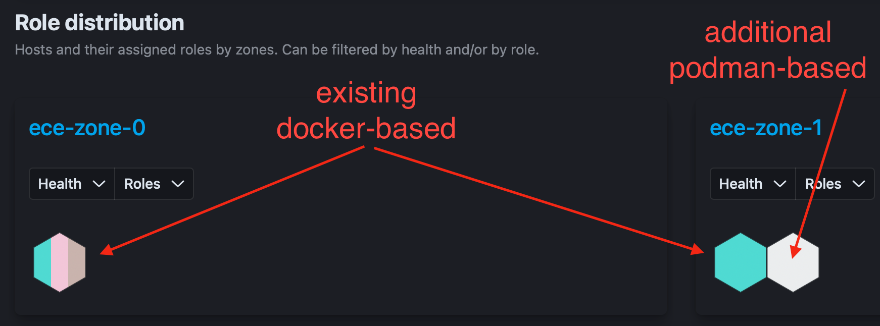

  8. Login to admin console
    Verify that the new podman host has the same roles (same coloring of the hexagon) as the docker host you want to replace.
    The following screenshot shows the state where the correct roles have been applied. Both hosts in ece-zone-1 have the same color.
    Correct role
    The following screenshot shows the state where incorrect roles have been applied. The hosts in ece-zone-1 do not have the same coloring.
    Wrong role

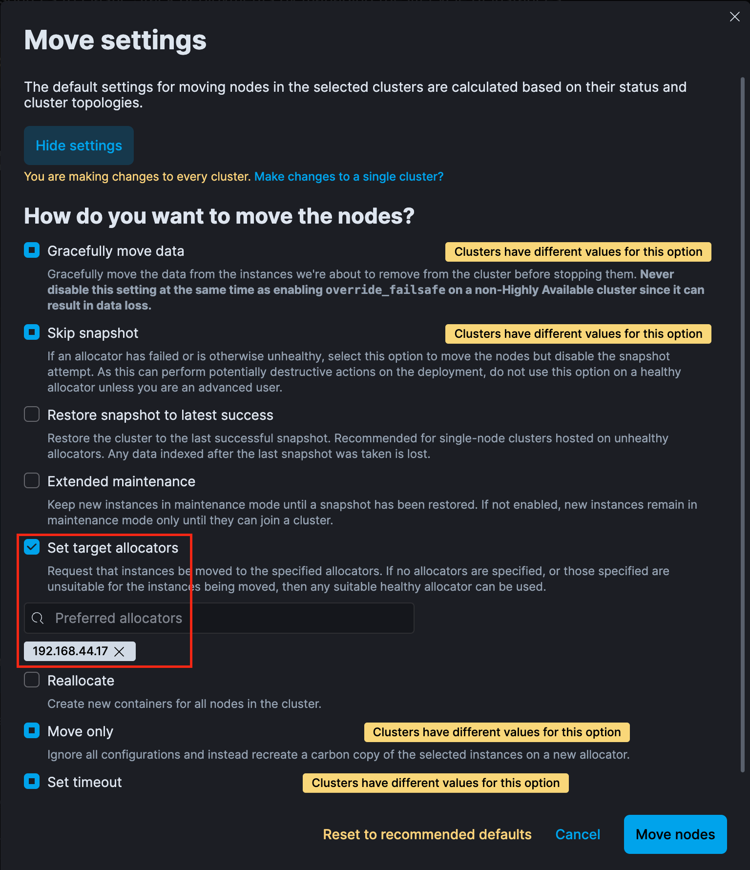

  10. Move all instances from the docker allocator to the podman allocator by following the Move Nodes From Allocators documentation.
    Make sure to specify the target podman allocator using the option “Set target allocators”.
    If you move admin console instances, you might update the URL in the browser before continuing with step 11.
    Move instances
    As an alternative, use the Move clusters API.
