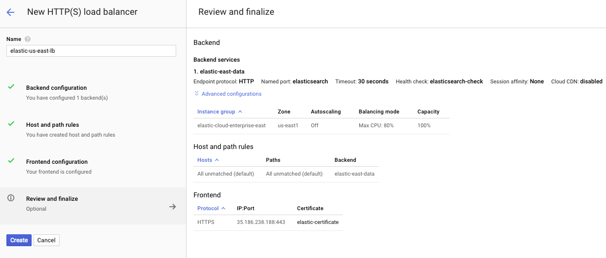

GCP load balanceredit
The following steps show you how to configure HTTPS load balancing for your instance group on GCP. Elastic Cloud Enterprise is designed to be used in conjunction with at least one load balancer.
To learn more about how HTTPS load balancing works on GCP, check Google Cloud Load Balancing and Creating Cross-Region Load Balancing.
These steps require that you already have a signed SSL certificate that you can use with a wildcard DNS certificate.
To set up a load balancer with GCP:
  1. Log into the Google Cloud Platform console.
  2. Go to the Networking panel through the Products & services menu and select Load balancing.
  3. Select Create load balancer and select Start configuration under HTTP(S) Load Balancing.
  4. Name your new load balancer.
  5. Configure the backend service:
    1. Select Backend Configuration and then select Create a new backend service.
    2. Name the new service and under New Backend select the instance group you created earlier.
    3. When prompted, select USE EXISTING PORT NAME.
    4. Under Health Check, select the dropdown menu to create a health check:
    5. Set the port to 9200 and leave the other fields at their defaults.
    6. Select Save and continue.
  6. Set the host and path rules:
    1. Under Backends, select the backend you just configured.
  7. Configure the frontend:
    1. Select Frontend Configuration, set the protocol to HTTTPS, and for the IP select to Create IP address.
    2. When prompted, name the new static IP address and select RESERVE.
    3. Under Certificate, select Create a new certificate.
    4. Name the new certificate and upload your wild card certificate details, then select Create.
  8. Select Create to create the new load balancer:
    Load balancing configured on GCP
    Creating the load balancer takes a few moments.
Next steps: If you use a wildcard DNS record, update the record to point to the IP address of the load balancer. The IP address can be found on the Load balancing tab when you select the load balancer you just created.
