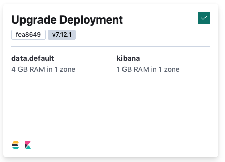

    Just for reference, here is the same deployment in the UI:
    The Upgrade Deployment card in the ECE UI

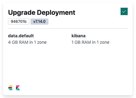

    You can also confirm the change in the UI:
