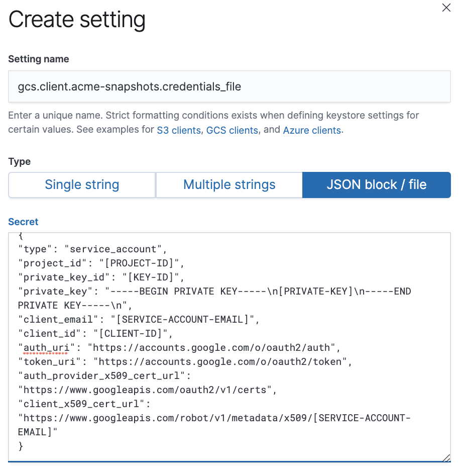

  1. Add a secure setting named gcs.client.acme-snapshots.credentials_file as a JSON block. Make sure that the client name is the same one you provided when configuring the snapshot repository.
    GCS client secret configuration
    The contents within credentials_file must be the exact contents of your GCS credentials file.
