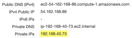

  1. Compare the URL you are trying to reach to the host IP address information in the AWS EC2 Dashboard.
    For example, on a Elastic Cloud Enterprise installation, the following URLs might be provided by default:
    • Cloud UI: http://192.168.40.73:12400
    • Elasticsearch: https://e025c4xxxxxxxxxxxxx.192.168.40.73.ip.es.io:9243/
    • Kibana: https://1e2b57xxxxxxxxxxxxx.192.168.40.73.ip.es.io:9243/
    A quick check in the AWS EC2 Dashboard confirms that 192.168.40.73 is a private IP address, which is not accessible externally:
    Private IP address information in AWS EC2 Dashboard

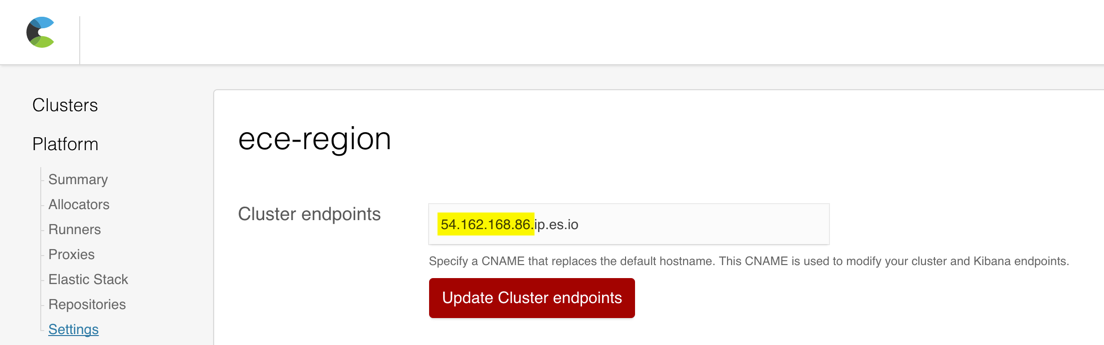

  2. To resolve this issue:
    • For the Cloud UI, use the public host name or public IP. In this example, the Cloud UI is accessible externally at ec2-54-162-168-86.compute-1.amazonaws.com:12400.
    • For Elasticsearch and Kibana, update your cluster endpoint to use the public IP address. In this example, you can use 54.162.168.86:
      Public IP address is used for cluster endpoints in the Cloud UI
