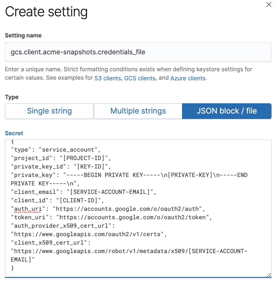

Add a secure setting named
gcs.client.acme-snapshots.credentials_file
as a JSON block. Make sure that the client name is the same one you provided when configuring the snapshot repository. -
as a JSON block. Make sure that the client name is the same one you provided when configuring the snapshot repository.The contents within credentials_file must be the exact contents of your GCS credentials file.
