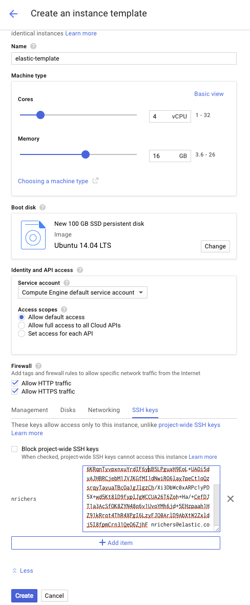

Create an instance template:
- Under Instance Templates, click CREATE INSTANCE TEMPLATE and name your template.
- Select a machine type, one of the supported Linux distributions as the boot disk and specify enough storage. Make sure that the template meets the prerequisites for Elastic Cloud Enterprise.
- Set the Firewall to allow both HTTP and HTTPS access.
- On the Networking tab, set IP forwarding to on.
- On the SSH keys tab, add your public SSH key.
Click Create:

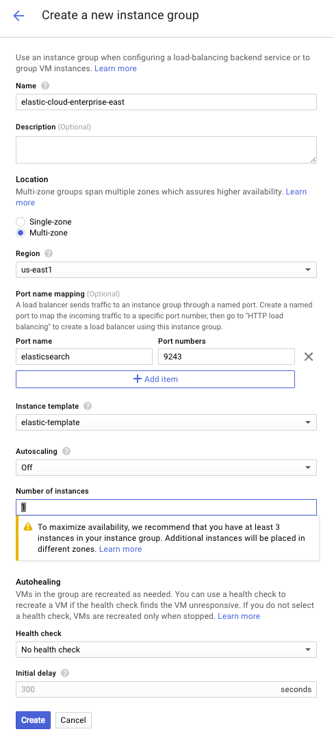

Create an instance group:
- Return to the Compute Engine panel through the Products & services menu.
- Select the Instance groups panel, click Create instance group, and name your group.
- Under Location, select Multi-zone and select a region.
Click Specify port name mapping and add port 9243, which is the port used by Kibana and Elasticsearch for HTTPS access.
If you are using a load balancer or firewall, consider adding port 443. To add a port, click Add item. On each host in the Elastic Cloud Enterprise cluster, run
sudo iptables -A PREROUTING -t nat -p tcp --dport 443 -j REDIRECT --to-ports 9243. - Select the instance template you created earlier.
- Specify the number of instances to create. For high availability, select at least three instances. These instances are placed into separate zones. See our deployment recommendations for how many instances you might need to bring up a production Elastic Cloud Enterprise installation.
Click Create:
