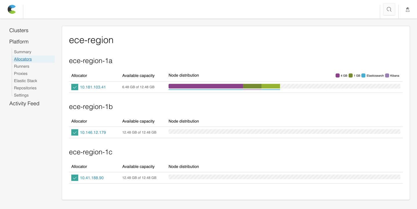

Check the available capacity:
- Log into the Cloud UI.
From the Platform menu, select Allocators to view the available capacity.
Narrow the list by name, ID, or choose from several other filters. To further define the list, use a combination of filters.
In this case 3 GB and 6 GB on two different allocators:
