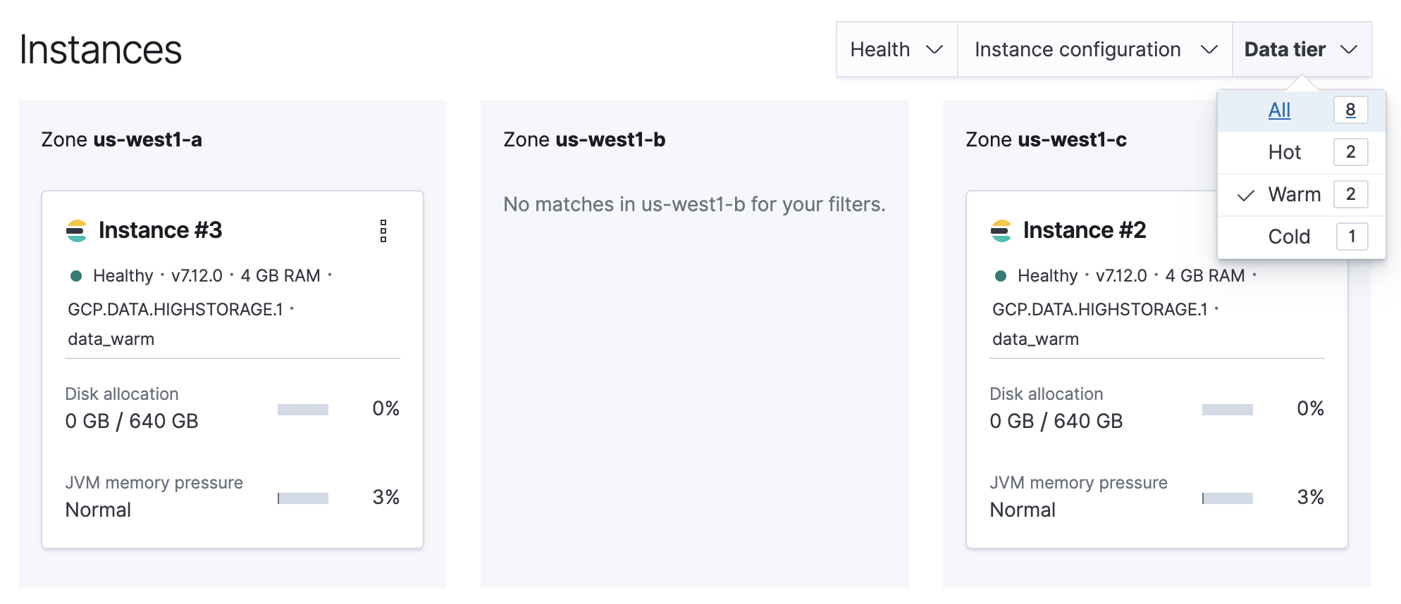

Determine which nodes will be removed from the cluster.
- Log into the Cloud UI.
From the Deployments page, select your deployment.
Narrow the list by name, ID, or choose from several other filters. To further define the list, use a combination of filters.
Filter the list of instances by the Data tier you want to disable.
Note the listed instance IDs. In this example, it would be Instance 2 and Instance 3.

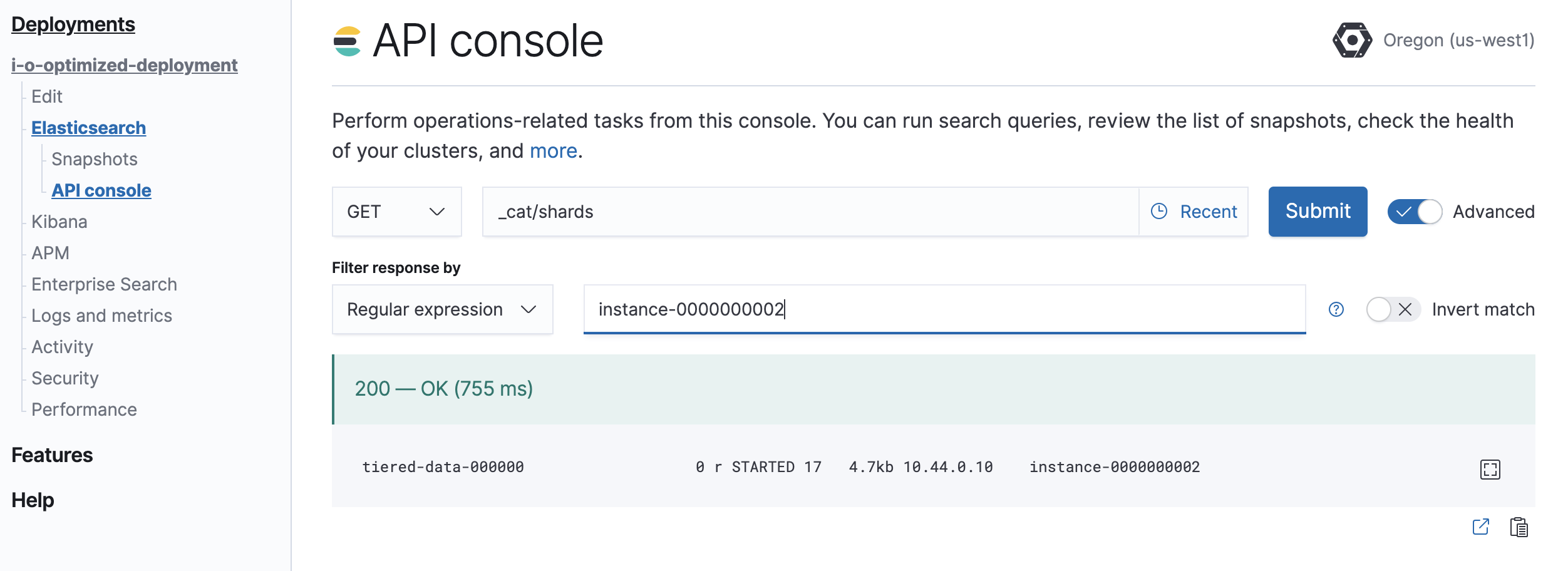

Determine which shards need to be moved.
GET /_cat/shards
Parse the output, looking for shards allocated to the nodes to be removed from the cluster. Note that
Instance #2
is shown asinstance-0000000002
in the output. -
