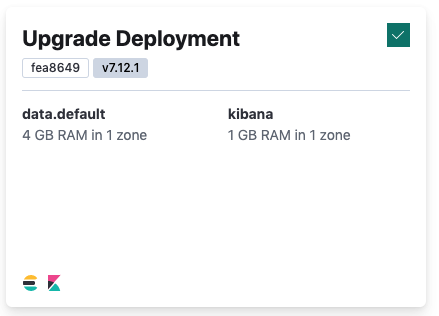

    Just for reference, here is the same deployment in the UI:
    The Upgrade Deployment card in the ECE UI

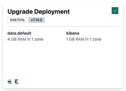

  3. After the upgrade operation completes, the Elasticsearch and Kibana resource will be at version 7.14.0. You can confirm that by running:
    curl -k -X GET -H "Authorization: ApiKey $ECE_API_KEY" https://$COORDINATOR_HOST:12443/api/v1/deployments/$DEPLOYMENT_ID
            "elasticsearch" : {
              "version" : "7.14.0"
            "kibana" : {
              "version" : "7.14.0",
    You can also confirm the change in the UI:
