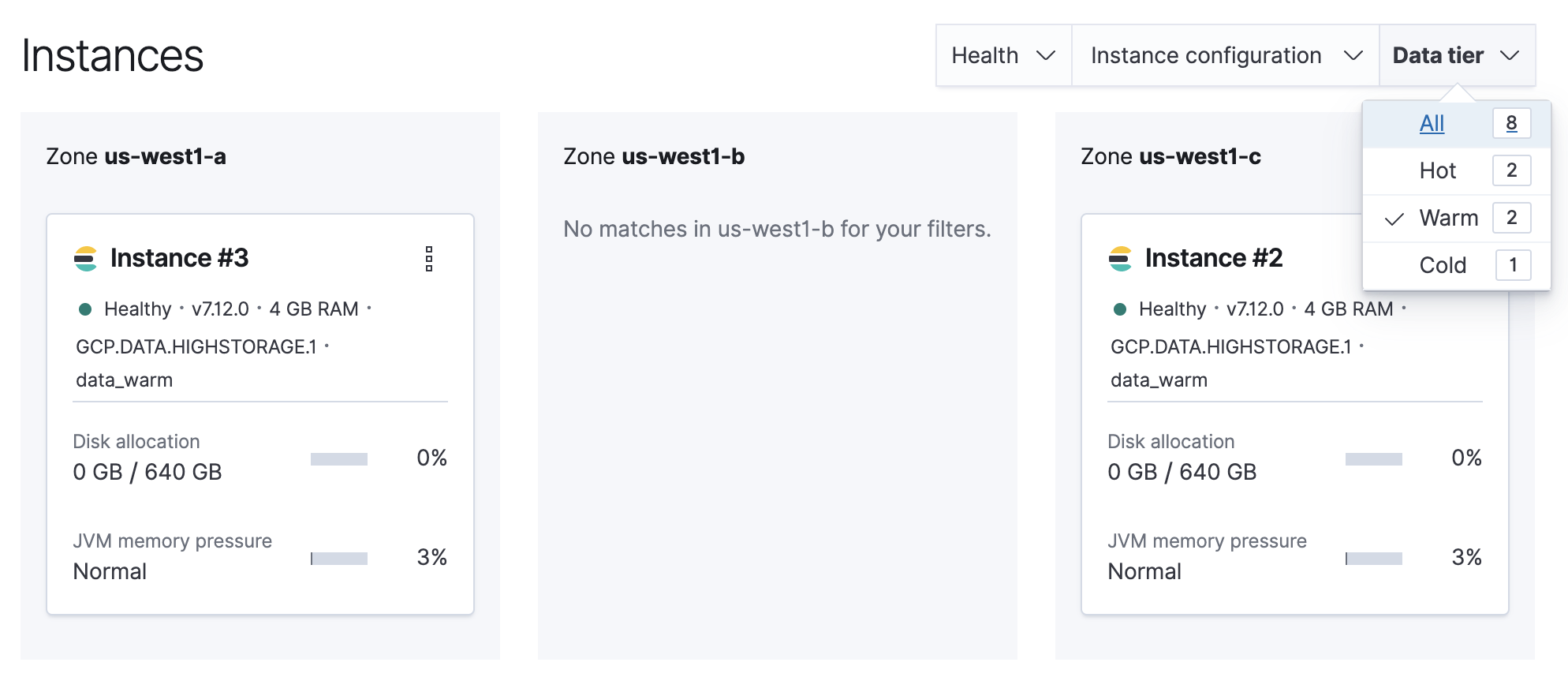

  1. Determine which nodes will be removed from the cluster.
    1. Log into the Cloud UI.
    2. From the Deployments page, select your deployment.
      Narrow the list by name, ID, or choose from several other filters. To further define the list, use a combination of filters.
    3. Filter the list of instances by the Data tier you want to disable.
      A screenshot showing a filtered instance list
      Note the listed instance IDs. In this example, it would be Instance 2 and Instance 3.

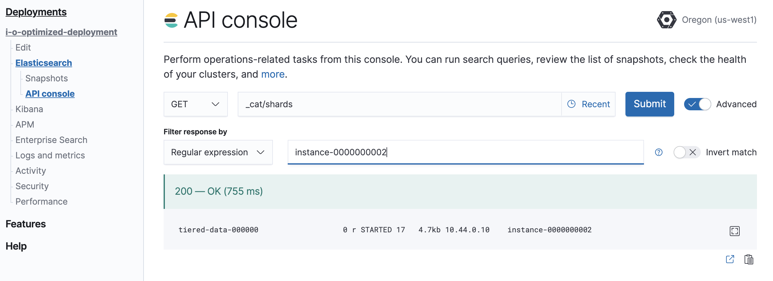

  3. Determine which shards need to be moved.
    GET /_cat/shards
    Parse the output, looking for shards allocated to the nodes to be removed from the cluster. Note that Instance #2 is shown as instance-0000000002 in the output.
    A screenshot showing a filtered shard list
