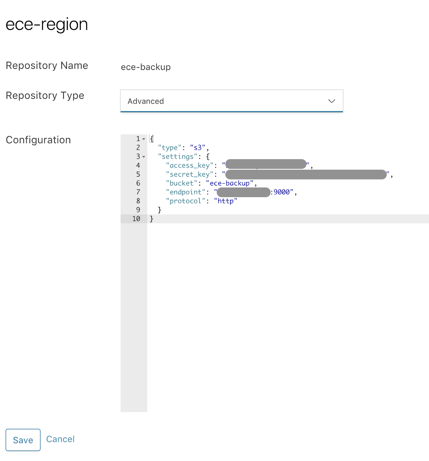

  4. From the Repository Type drop-down list, select Advanced.
  5. In the Configuration text area, provide the repository JSON. You must specify the bucket, access_key, secret_key, endpoint, and protocol.
         "type": "s3",
          "settings": {
             "bucket": "ece-backup",
             "access_key": "<your Minio AccessKey>",
             "secret_key": "<your Minio SecretKey>",
             "endpoint": "<your Minio endpoint URL>:9000",
             "protocol": "http"
    Create form
  6. Click Save to submit your configuration.

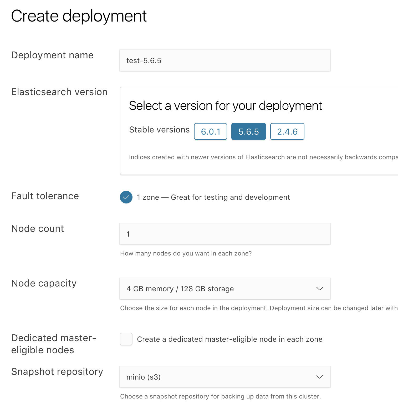

The Minio repository is now available from the drop-down list of repositories when creating deployments.
Create deployment
Additional Settings for 6.x Clustersedit
For Elasticsearch versions 6.0 and later, after selecting the repository, you also need to set your User Settings YAML to specify the endpoint and protocol. For example:
s3.client.default.endpoint: "<your Minio endpoint>:9000"
s3.client.default.protocol: http
See the Elasticsearch S3 plugin details for more information.
