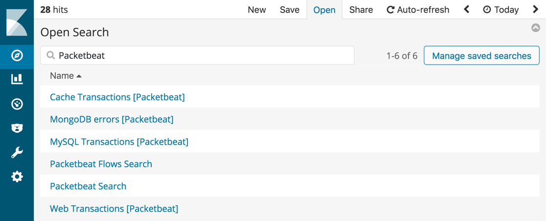

To make it easier for you to search and discover Packetbeat data in Kibana, the sample dashboards contain predefined searches. These searches are not default views on the Discover page. To use these searches, make sure you’ve set up the example Kibana dashboards. Then go to the Discover page and click Open.
Type Packetbeat
in the Search field to filter the list of searches.
![Saved Packetbeat Searches](./images/saved-packetbeat-searches.png)

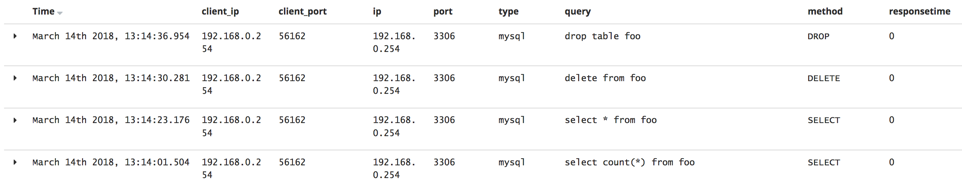

You can use the predefined searches to customize the columns in the Discover table. For example, select the Packetbeat Search to customize the columns in the Discover table:
![Packetbeat Search](./images/discovery-packetbeat-transactions.png)

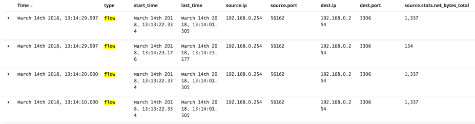

Select the Packetbeat Flows Search to display the most important information for Packetbeat flows:
![Packetbeat Flows Search](./images/discovery-packetbeat-flows.png)
