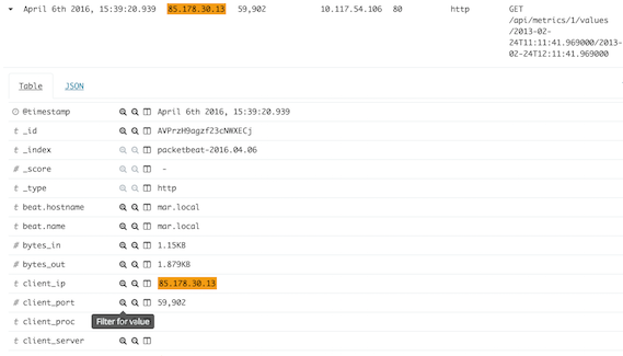

Create filtersedit
In Kibana, you can also filter transactions by clicking on
elements within a visualization. For example, to filter for all the HTTP redirects that are coming from a specific
IP and port, click the "Filter for value" icons (highlighted in green below) for the client_ip
and client_port
fields in the transaction detail widget. To
exclude the HTTP redirects coming from the IP and port, click the icons highlighted in red.
The selected filters appear under the search box.
