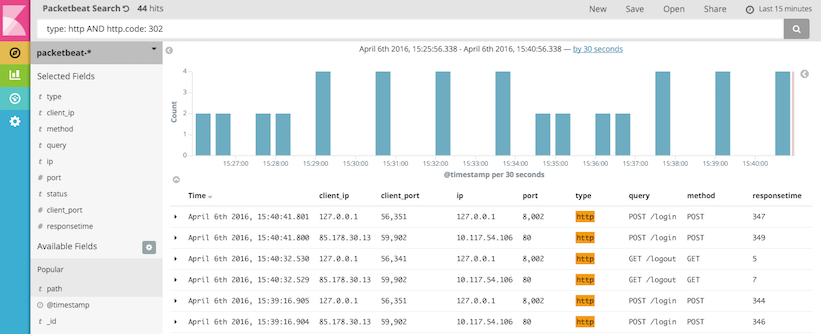

It allows boolean operators, wildcards, and field filtering. For example, if
you want to find the HTTP redirects, you can search for
type: http AND http.response.code: 302.

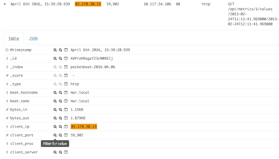

editIn Kibana, you can also filter transactions by clicking on
elements within a visualization. For example, to filter for all the HTTP redirects that are coming from a specific

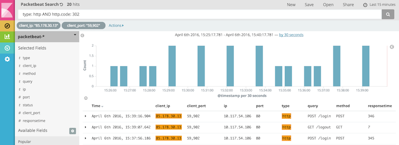

IP and port, click the "Filter for value" icons (highlighted in green below) for the client_ip and client_port fields in the transaction detail widget. To
exclude the HTTP redirects coming from the IP and port, click the icons highlighted in red.
The selected filters appear under the search box.
