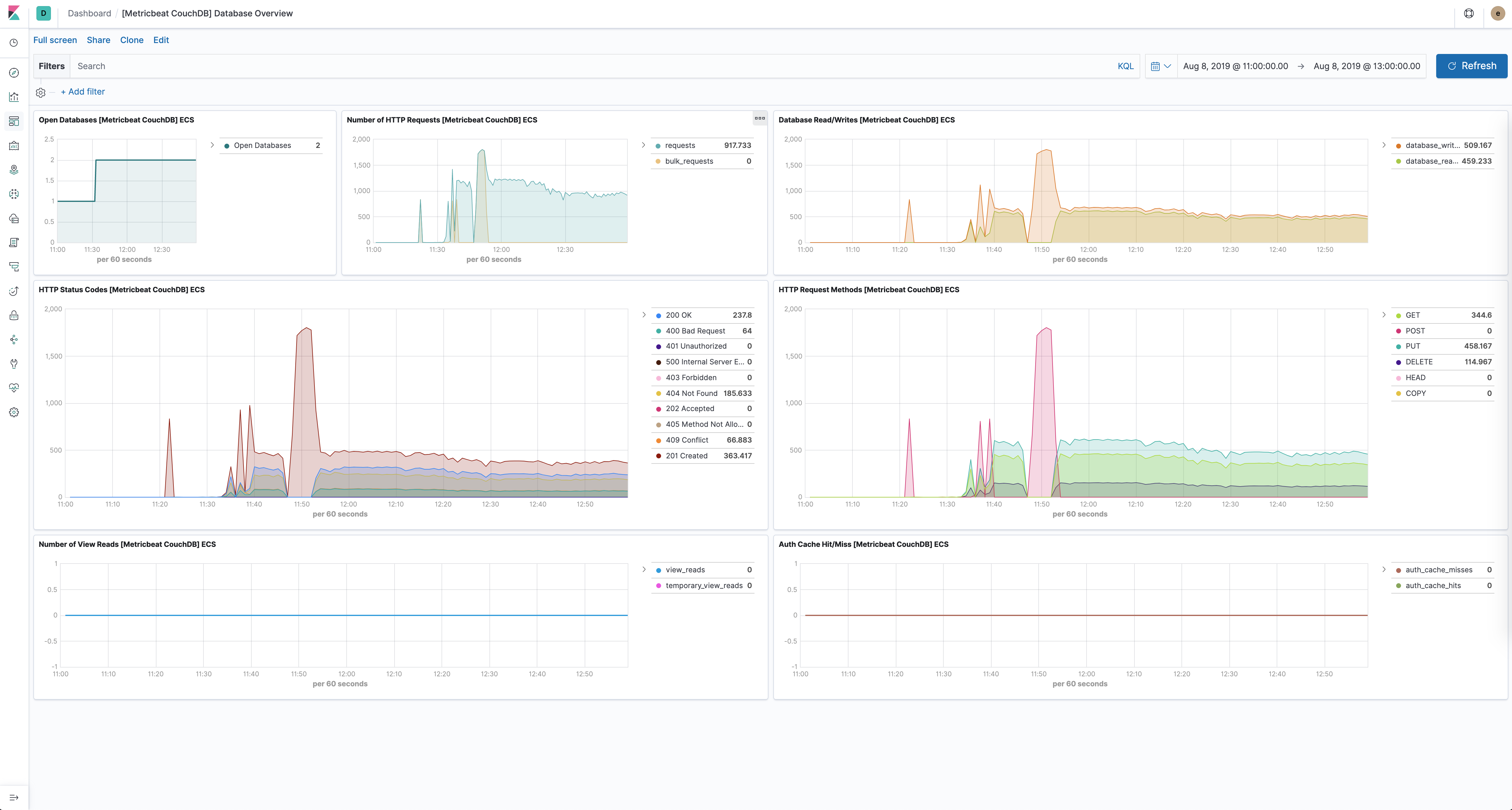

Dashboardedit
The CouchDB module comes with a predefined dashboard for CouchDB database specific stats. For example:
metricbeat couchdb overview
