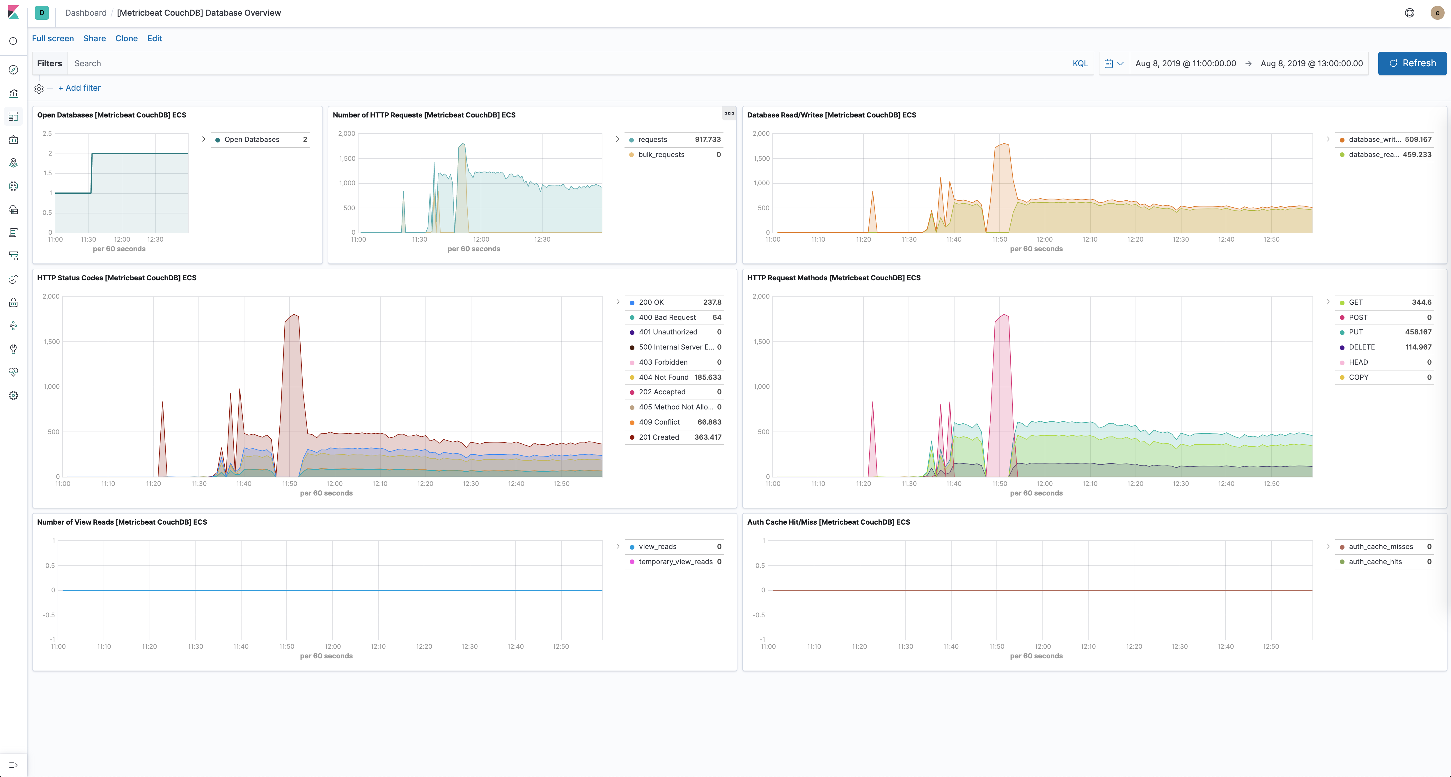

Dashboard
editThe CouchDB module comes with a predefined dashboard for CouchDB database specific stats. For example:
