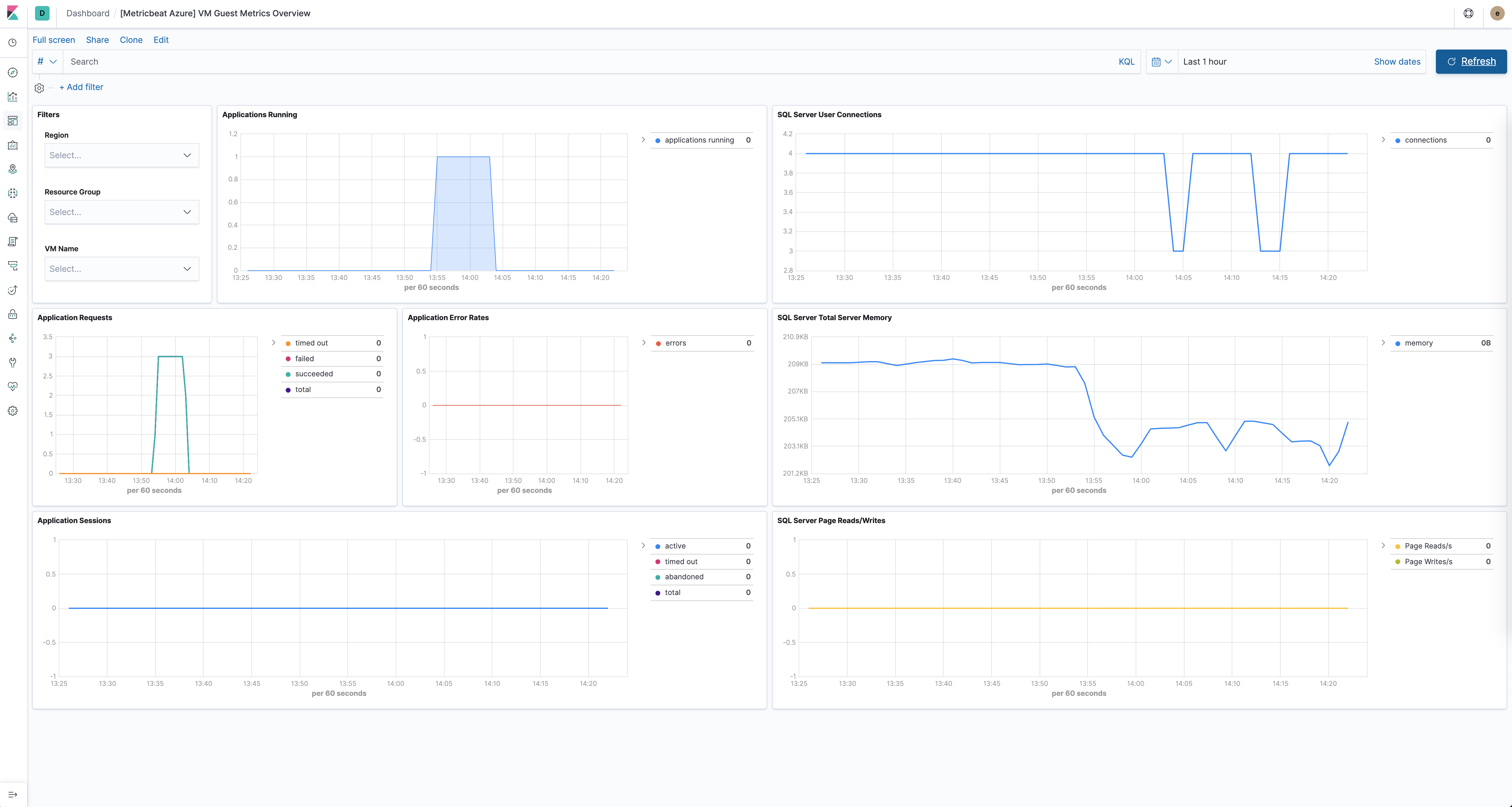

To populate the VM Guest Metrics Overview dashboard, users will have to enable the Virtual Machine Guest namespace for the monitored resources. More on sending guest OS metrics to Azure Monitor here https://docs.microsoft.com/en-us/azure/azure-monitor/platform/collect-custom-metrics-guestos-resource-manager-vm.
