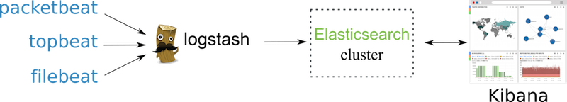

editThe simplest architecture for the Beats platform setup consists of one or more Beats, Elasticsearch, and Kibana. This architecture is easy to get started with and sufficient for networks with low traffic. It also uses the minimum amount of servers: a single machine running Elasticsearch and Kibana. The Beats insert the transactions directly into the Elasticsearch instance.
If you want to perform additional processing or buffering on the data, however, you’ll want to install Logstash.
An important advantage to this approach is that you can use Logstash to modify the data captured by Beats in any way you like. You can also use Logstash’s many output plugins to integrate with other systems.
