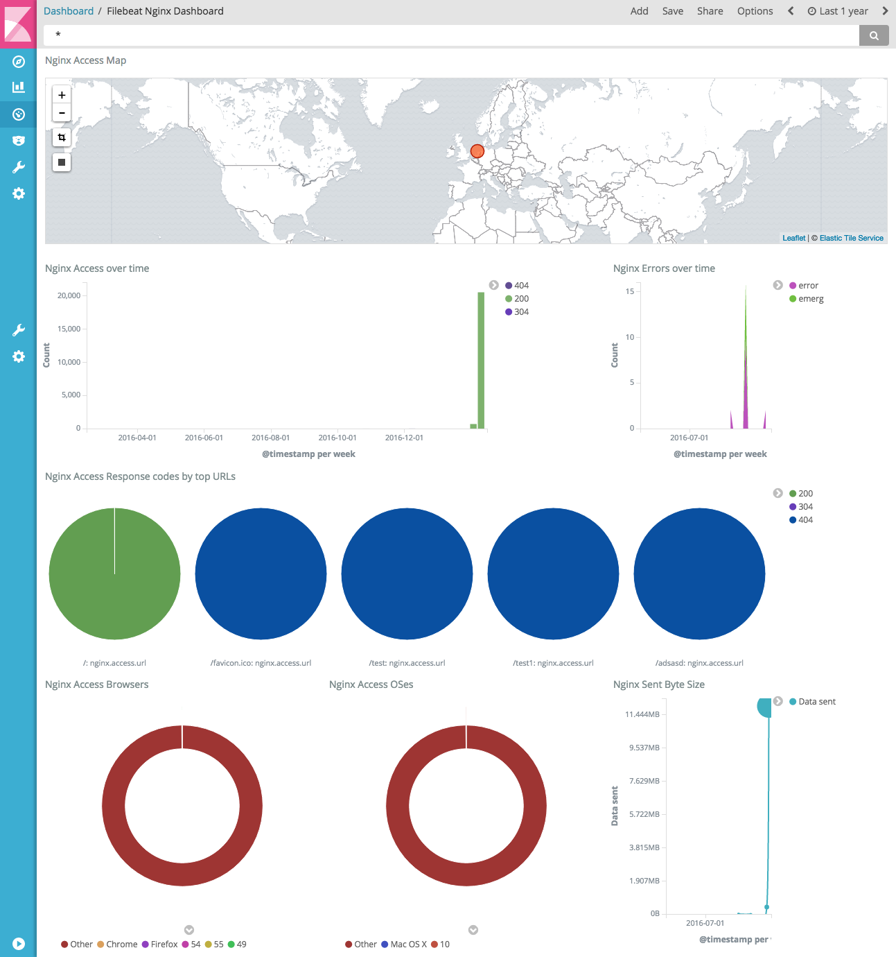

Visiting the Kibana web interface now, open the Nginx dashboard and you should already see your logs parsed and visualized in several widgets.
