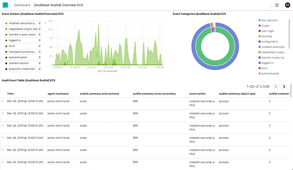

Step 6: View your data in Kibanaedit
To make it easier for you to start auditing the activities of users and processes on your system, Auditbeat comes with pre-built Kibana dashboards and UIs for visualizing your data.
To open the dashboards:
Launch Kibana:
- Log in to your Elastic Cloud account.
- Navigate to the Kibana endpoint in your deployment.
Point your browser to http://localhost:5601, replacing
localhost
with the name of the Kibana host. -
In the side navigation, click Discover. To see Auditbeat data, make sure the predefined
auditbeat-*
index pattern is selected.If you don’t see data in Kibana, try changing the time filter to a larger range. By default, Kibana shows the last 15 minutes.
- In the side navigation, click Dashboard, then select the dashboard that you want to open.
