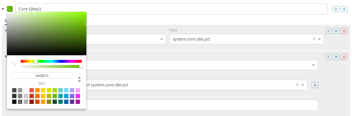

Series Label and Coloredit
Each series supports a label which will be used for legends and titles depending on
which visualization type is selected. For series that are grouped by a term, you
can specify a mustache variable of {{key}}
to substitute the term. For most
visualizations you can also choose a color by clicking on the swatch, this will display
the color picker.

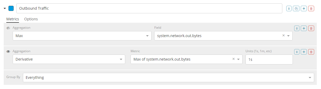

Metricsedit
Each series supports multiple metrics (aggregations); the last metric (aggregation) is the value that will be displayed for the series, this is indicated with the "eye" icon to the left of the metric. Metrics can be composed using pipeline aggregations. A common use case is to create a metric with a "max" aggregation then create a "derivative" metric and choose the previous "max" metric as the source; this will create a rate.

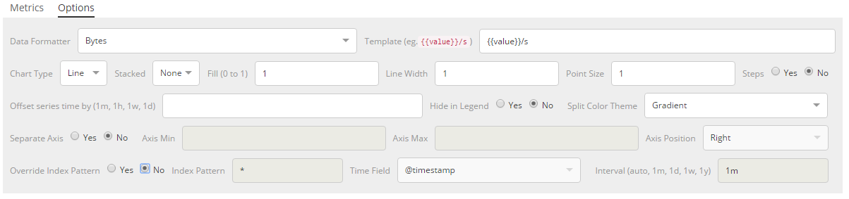

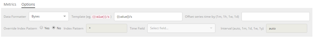

Series Optionsedit
Each series also supports a set of options which are dependent on the type of visualizations you have selected. Universal across each visualization type you can configure:
- Data format
- Time range offset
- Index pattern, timestamp, and interval override
For the Time Series visualization you can also configure:
- Chart type
- Options for each chart type
- Legend Visibility
- Y-Axis options
- Split color theme
Group By Controlsedit
At the bottom of the metrics there is a set of "Group By" controls that allows you to specify how the series should be grouped or split. There are four choices:
- Everything
- Filter (single)
- Filters (multiple with configurable colors)
- Terms
By default the series is grouped by everything.

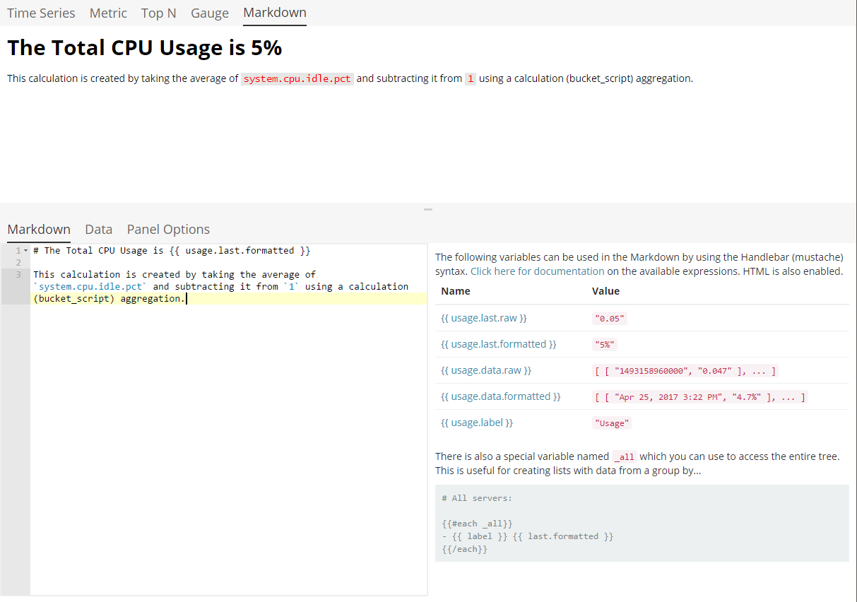

Markdown
- Panel filter
- Background color
- Scroll bar visibility
- Vertical alignment of content
- Custom Panel CSS with support for Less syntax

Markdown Tabedit
The markdown tab is used for editing the source for the Markdown visualization. The user interface has an editor on the left side and the available variables from the data tab on the right side. You can click on the variable names to insert the mustache template variable into the markdown at the cursor position. The mustache syntax uses the Handlebar.js processor which is an extended version of the Mustache template language.
Style Markdown textedit
Style your Markdown visualization using less syntax.
- Select Markdown.
- Select Panel options.
Enter styling rules in Custom CSS section
Less in TSVB does not support custom plugins or inline JavaScript.
