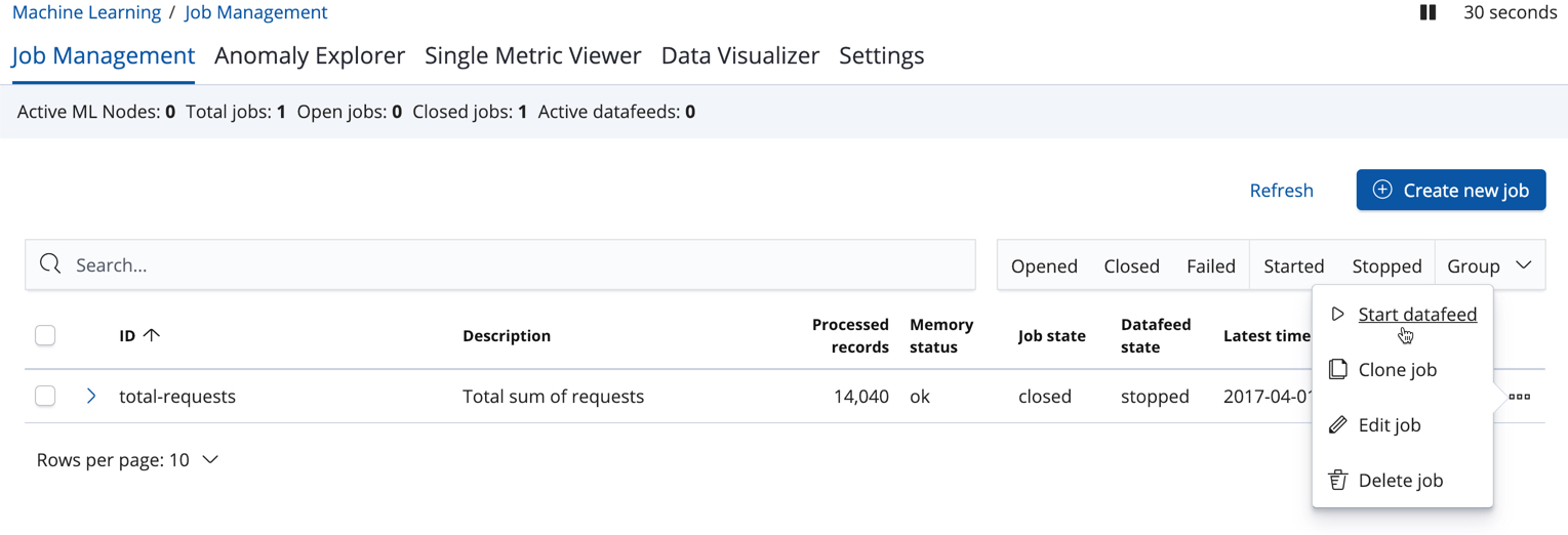

After you create a job, you can see its status in the Job Management tab:
![Status information for the total-requests job](images/ml-gs-job1-manage1.jpg)
The following information is provided for each job:

If you click the arrow beside the name of job, you can show or hide additional information, such as the settings, configuration information, or messages for the job.
You can also click one of the Actions buttons to start the datafeed, edit the job or datafeed, and clone or delete the job, for example.

In the Machine Learning / Job Management tab, click Start datafeed in the actions column.
Choose a start time and end time. For example, click Continue from 2017-04-01 23:59:00 and select 2017-04-30 as the search end time. Then click Start. The date picker defaults to the latest timestamp of processed data. Be careful not to leave any gaps in the analysis, otherwise you might miss anomalies.
