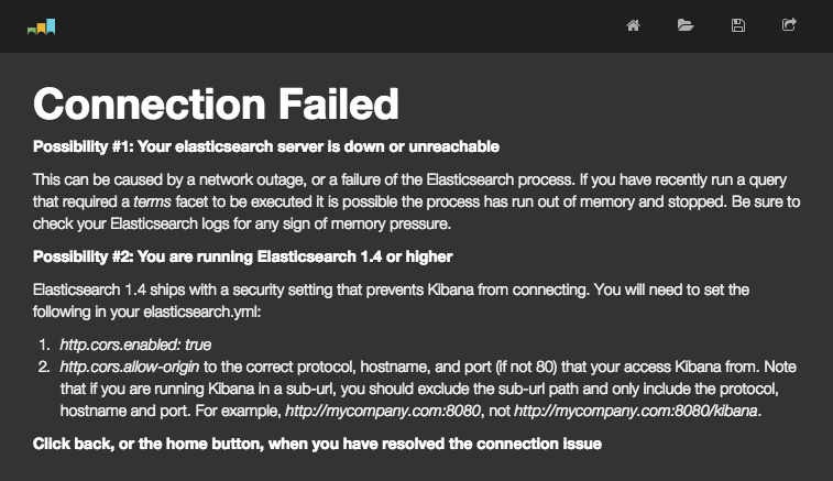

Now point your browser to port 8000, and you should see the Kibana web interface. It will probably complain that it cannot reach Elasticsearch, like in the following screenshot:
This is because
cross-origin resource sharing (CORS) is
disabled by default in recent versions of Elasticsearch to respect the "secure
by default" philosophy. You can enable CORS by adding the following lines to the
end of the /etc/elasticsearch/elasticsearch.yml
file:
http.cors.enabled: true http.cors.allow-origin: http://localhost:8000
Make sure that you replace http://localhost:8000
with the URL under which you
access Kibana up to the first slash. Restart Elasticsearch:
sudo /etc/init.d/elasticsearch restart
And try again to access Kibana in your browser. You should now see Kibana’s welcome page.
