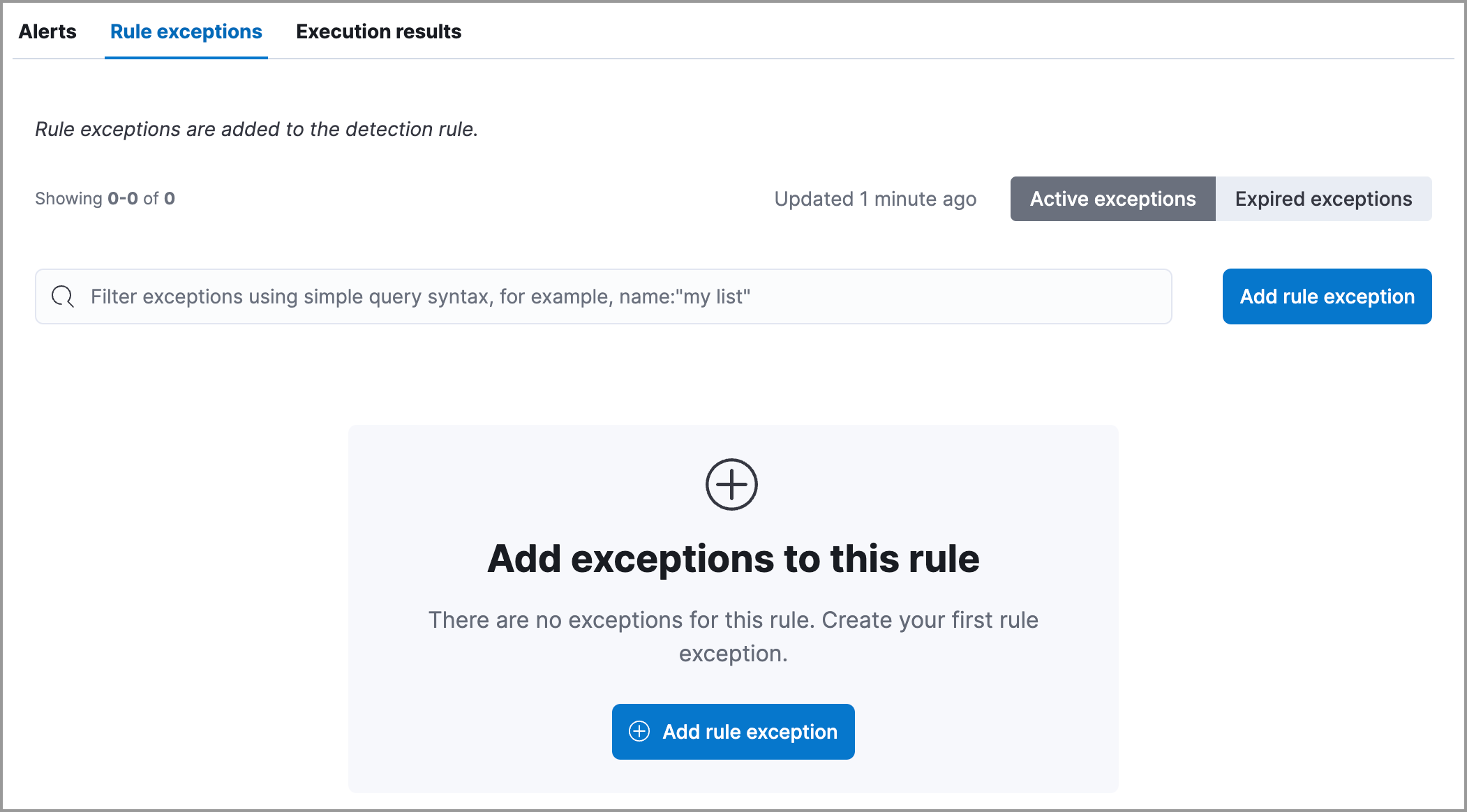

To add an exception from the rule details page:
- Go to the rule details page of the rule to which you want to add an exception (Rules → Detection rules (SIEM) → Rule name).
Scroll down the rule details page, select the Rule exceptions tab, then click Add rule exception.

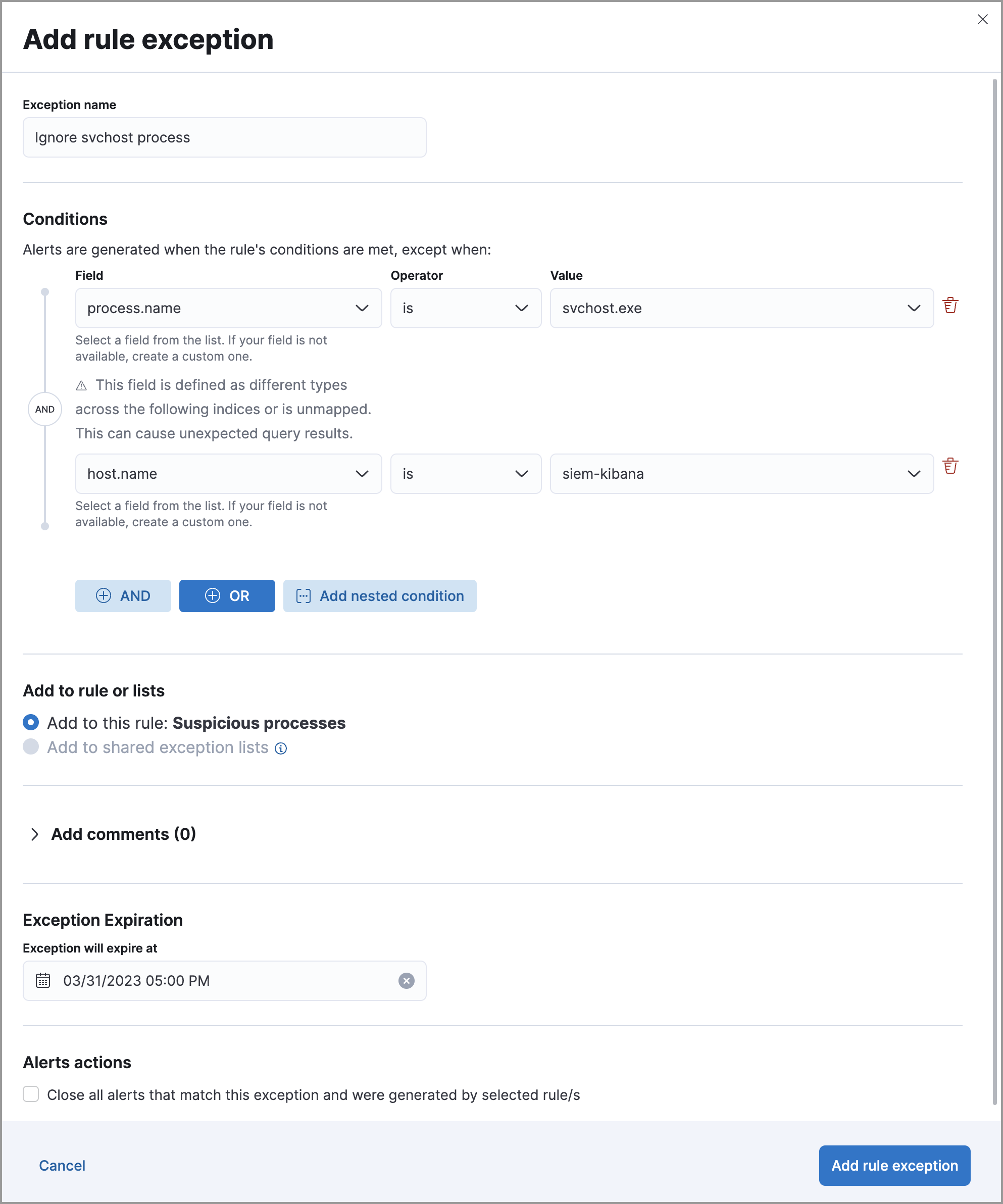

- In the Add rule exception flyout, name the exception.
Add conditions that define the exception. When the exception’s query evaluates to
true
, rules don’t generate alerts even when their criteria are met.Rule exceptions are case-sensitive, which means that any character that’s entered as an uppercase or lowercase letter will be treated as such. In the event you don’t want a field evaluated as case-sensitive, some ECS fields have a
.caseless
version that you can use.When you create a new exception from an alert, exception conditions are auto-populated with relevant alert data. Data from custom highlighted fields is listed first. A comment that describes the auto-generated exception conditions is also added to the Add comments section.

, add both values to the Value field.In the following example, the exception was created from the Rules page and prevents the rule from generating alerts when the
svchost.exe
process runs on hostnamesiem-kibana
- Click AND or OR to create multiple conditions and define their relationships.

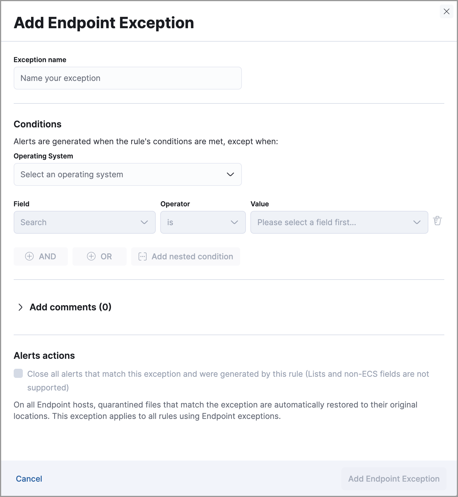

Do one of the following:
To add an Endpoint exception from the rule details page:
- Go to the rule details page (Rules → Detection rules (SIEM)), and then search for and select the Elastic Endpoint Security rule.
- Scroll down the rule details page, select the Endpoint exceptions tab, then click Add endpoint exception.
To add an Endpoint exception from the Alerts table:
- Go to Alerts.
- Scroll down to the Alerts table, and from an Elastic Endpoint alert, click the More actions menu (…), then select Add Endpoint exception.
To add an Endpoint exception from Shared Exception Lists page:
- Go to Rules → Shared exception lists.
Expand the Endpoint Security Exception List or click the list name to open the list’s details page. Next, click Add endpoint exception.
The Endpoint Security Exception List is automatically created. By default, it’s associated with the Endpoint Security rule and any rules with the Elastic Endpoint exceptions option selected.

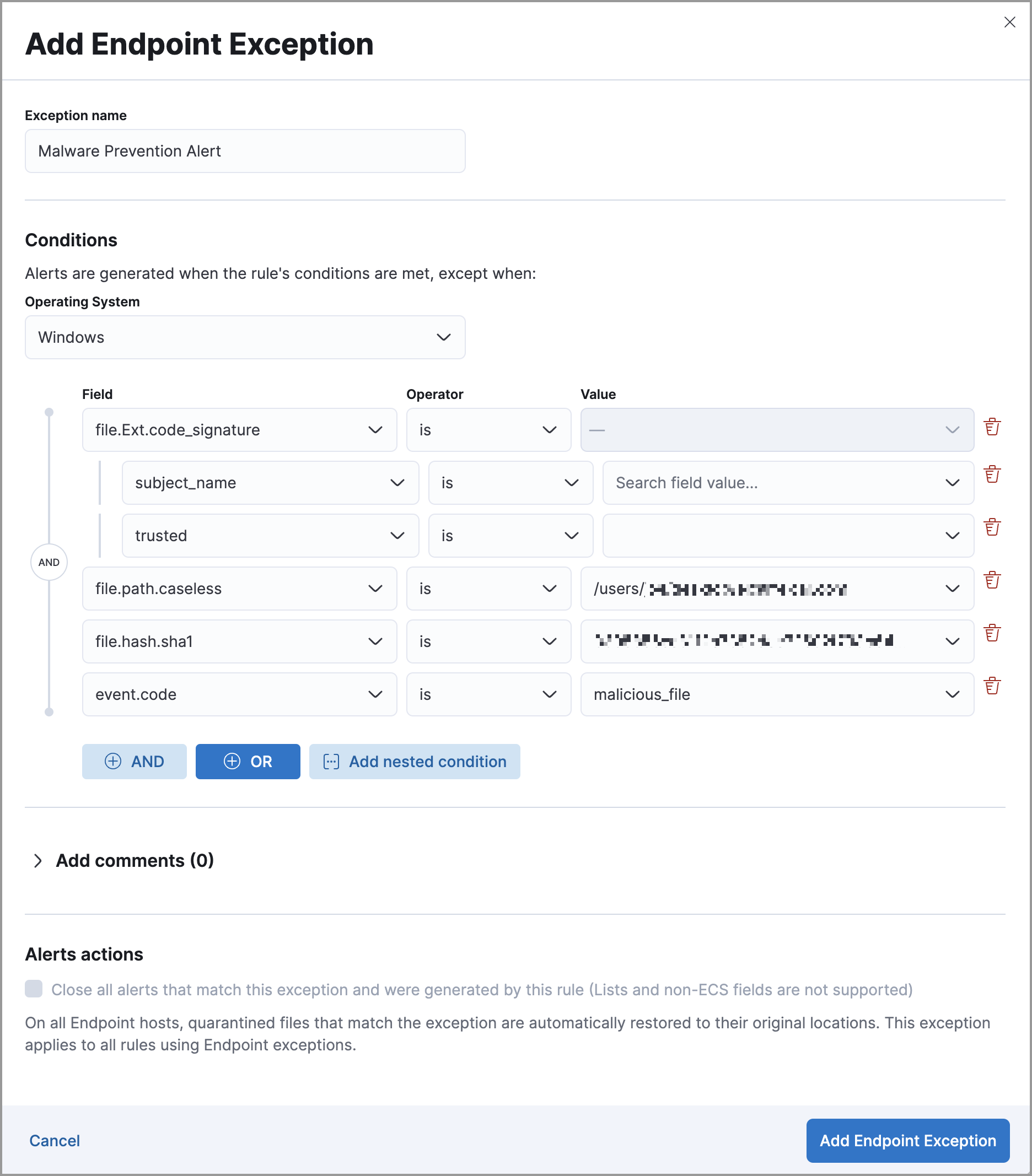

The Add Endpoint Exception flyout opens.
If required, modify the conditions.
.caseless
version that you can use.- Fields with conflicts are marked with a warning icon (). Using these fields might cause unexpected exceptions behavior. For more information, refer to Troubleshooting type conflicts and unmapped fields.

Exceptions with nested conditionsedit
Some Endpoint objects contain nested fields, and the only way to ensure you are
excluding the correct fields is with nested conditions. One example is the
process.Ext
object:

Nested condition exampleedit
Creates an exception that excludes all LFC-signed trusted processes:

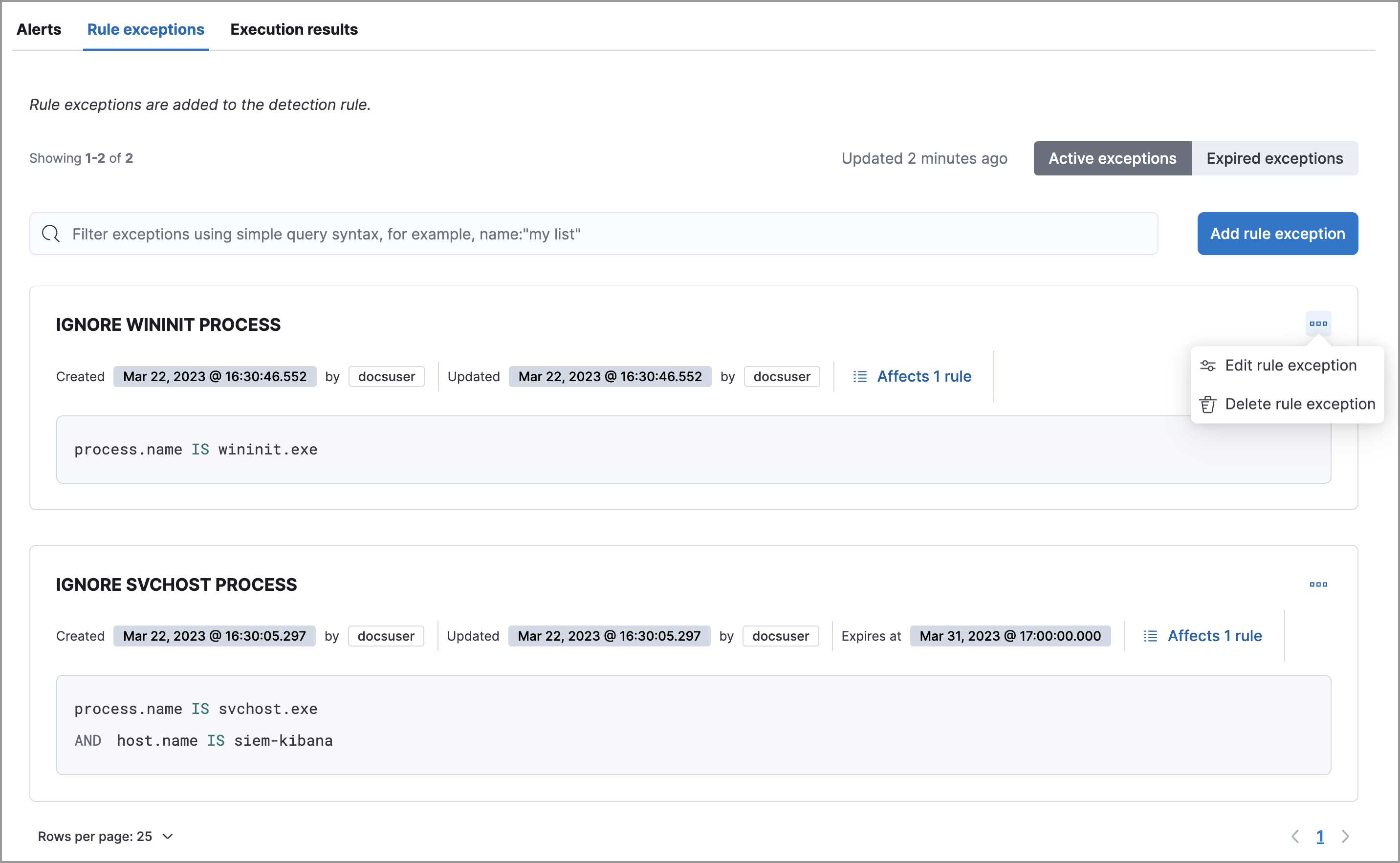

View and manage exceptionsedit
To view a rule’s exceptions, open the rule’s details page (Rules → Detection rules (SIEM) → Rule name), then scroll down and select the Rule exceptions or Endpoint exceptions tab. All exceptions that belong to the rule will display in a list. From the list, you can filter, edit, and delete exceptions. You can also toggle between Active exceptions and Expired exceptions.

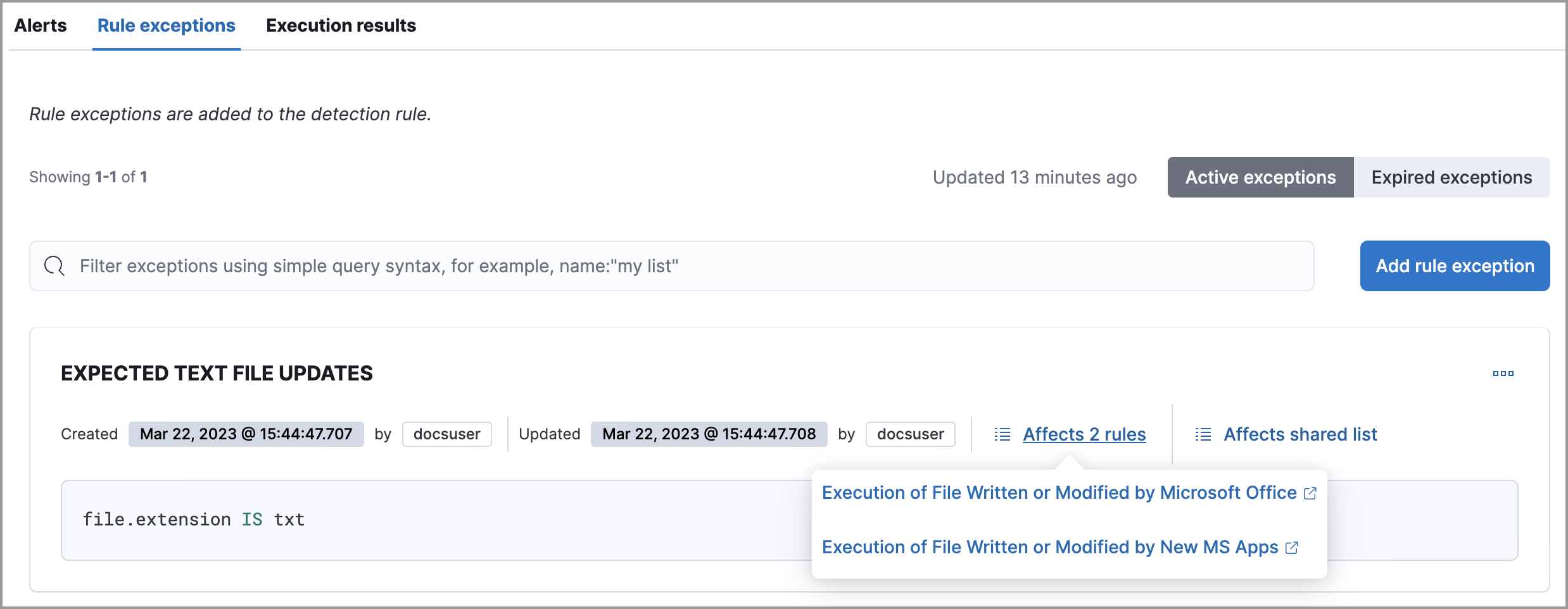

Find rules using the same exceptionsedit
To find out if an exception is used by other rules, select the Rule exceptions or Endpoint exceptions tab, navigate to an exception list item, then click Affects X rules.
Changes that you make to the exception also apply to other rules that use the exception.
