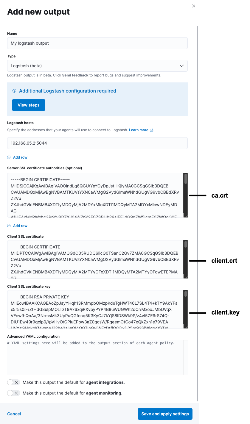

Add a Logstash output to Fleetedit
This section describes how to add a Logstash output and configure SSL settings in Fleet. If you’re running Elastic Agent standalone, refer to the Logstash output configuration docs.
- In Kibana, go to Fleet > Settings.
- Under Outputs, click Add output. If you’ve been following the Logstash steps in Fleet, you might already be on this page.
- Specify a name for the output.
- For Type, select Logstash.
Under Logstash hosts, specify the host and port your agents will use to
connect to Logstash. Use the format
host:port
In the Server SSL certificate authorities field, paste in the entire
contents of the
ca.crt
file you generated earlier. -
In the Client SSL certificate field, paste in the entire contents of the
client.crt
In the Client SSL certificate key field, paste in the entire contents of the
client.key
![Screen capture of a folder called `logstash` that contains two files: logstash.crt and logstash.key](images/add-logstash-output.png)
When you’re done, save and apply the settings.
