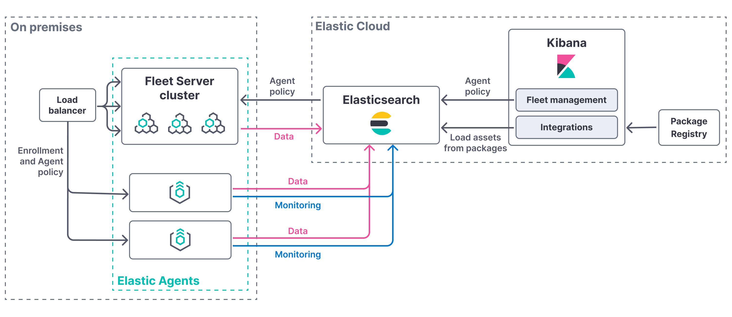

To use Fleet for central management, a Fleet Server must be running and accessible to your hosts.
Another approach is to deploy a cluster of Fleet Servers on-premises and connect them back to Elastic Cloud with access to Elasticsearch and Kibana. In this deployment model, you are responsible for high-availability, fault-tolerance, and lifecycle management of Fleet Server.
This approach might be right for you if you would like to limit the control plane traffic out of your data center. For example, you might take this approach if you are a managed service provider or a larger enterprise that segregates its networks.
This approach might not be right for you if you don’t want to manage the life cycle of an extra compute resource in your environment for Fleet Server to reside on.

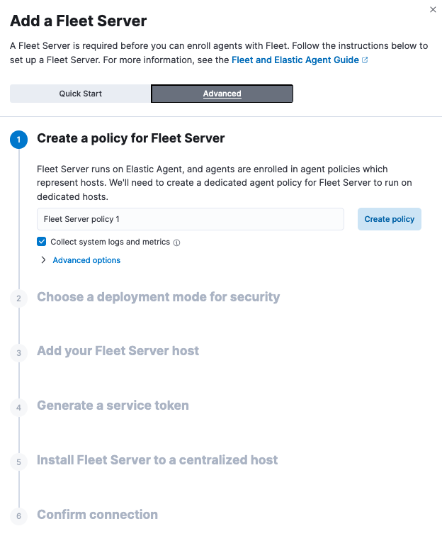

Now that the policy exists, you can add Fleet Servers.
A Fleet Server is an Elastic Agent that is enrolled in a Fleet Server policy. The policy configures the agent to operate in a special mode to serve as a Fleet Server in your deployment.
To add a Fleet Server:
- In Kibana, go to Management → Fleet
- Click the Agents tab.
- Click Add Fleet Server.
This will open in-product instructions for adding a Fleet Server using one of two options. Choose Advanced.
Follow the in-product instructions to add a Fleet Server.
- Select the agent policy that you created for this deployment.
Choose Production as your deployment mode.
Production mode is the fully secured mode where TLS certificates ensure a secure communication between Fleet Server and Elasticsearch.
Open the Fleet Server Hosts dropdown and select Add new Fleet Server Hosts.
Specify one or more host URLs your Elastic Agents will use to connect to Fleet Server.
For example,
https://192.0.2.1:8220
, where192.0.2.1
is the host IP where you will install Fleet Server. - A Service Token is required so the Fleet Server can write data to the connected Elasticsearch instance. Click Generate service token and copy the generated token.
- Copy the installation instructions provided in Kibana, which include some of the known deployment parameters.
Replace the value of the
--certificate-authorities
parameter with your CA certificate.
- If installation is successful, a confirmation indicates that Fleet Server is set up and connected.
After Fleet Server is installed and enrolled in Fleet, the newly created Fleet Server policy is applied. You can see this on the Fleet Server policy page.
The Fleet Server agent will also show up on the main Fleet page as another agent whose life-cycle can be managed (like other agents in the deployment).
