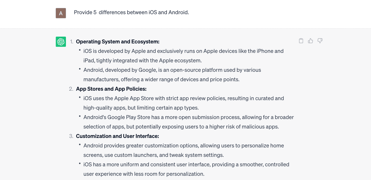

What is ChatGPT?
First things first, ChatGPT is awesome! It can help you work more efficiently — from summarizing a 10,000-word document to providing a list of differentiations between competing products, as well as many other tasks.

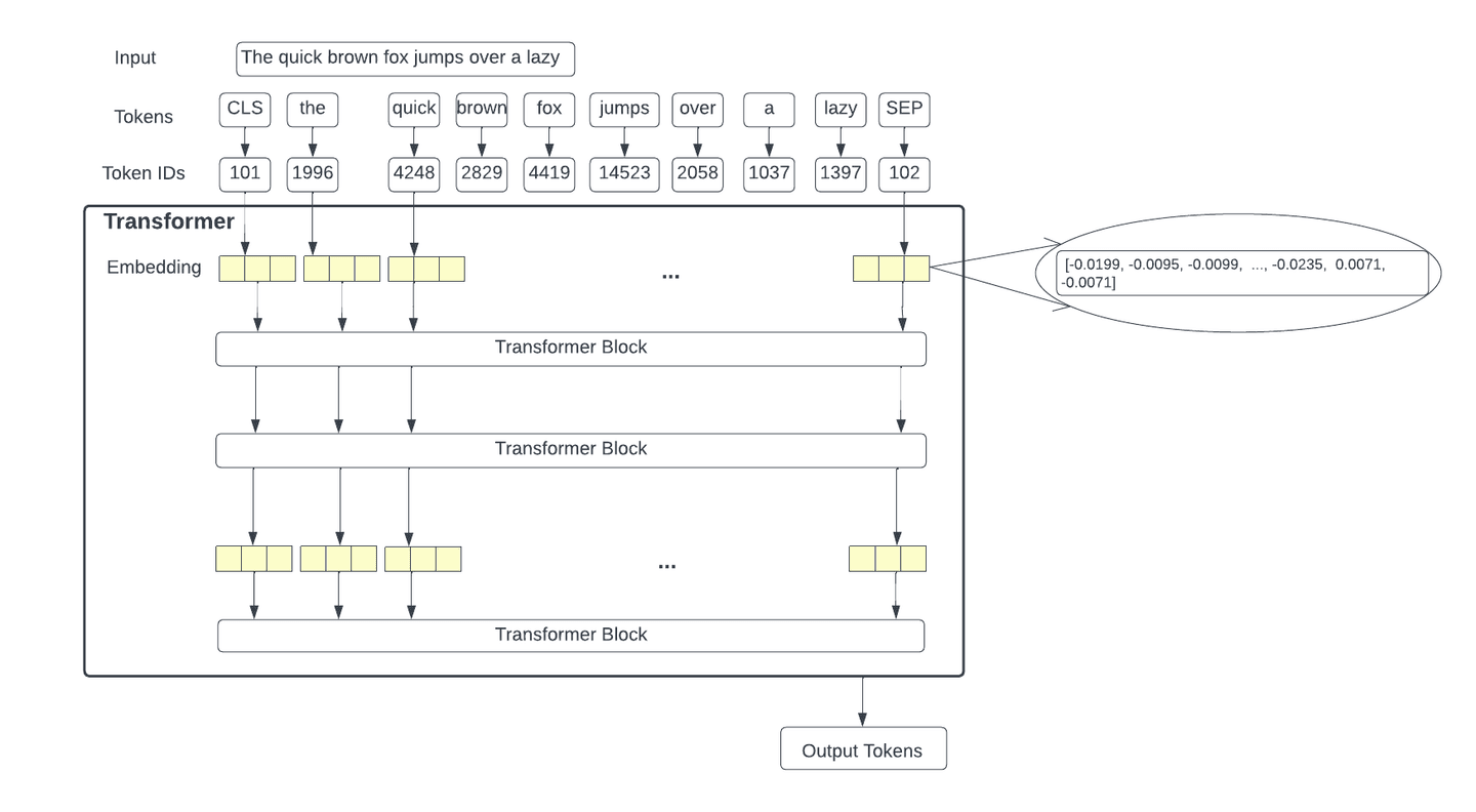

Tokens
Tokens are the basic units of text or code that an LLM uses to process and generate language. Tokens can be characters, words, subwords, or other segments of text or code, depending on the chosen tokenization method or scheme. They are assigned numerical values or identifiers and are arranged in sequences or vectors, then are fed into or outputted from the model. Tokenization is the process of splitting the input and output texts into smaller units that can be processed by the LLM models.
For example, the sentence “A quick brown fox jumps over a lazy dog” can be tokenized into the following tokens: “a,” “quick,” “brown,” “fox,” “jumps,” “over,” “a,” “lazy,” and “dog.”

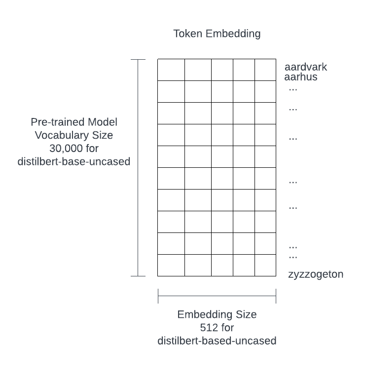

Embedding
Embeddings are vectors or arrays of numbers that represent the meaning and the context of the tokens that the model processes and generates. They are derived from the parameters of the model and are used to encode and decode the input and output texts. Embeddings help the model to understand the semantic and syntactic relationships between the tokens and to generate more relevant and coherent texts. They are essential components of the transformer architecture that GPT-based models use. They can also vary in size and dimension, depending on the model and the task.
At a minimum, pre-trained LLMs contain embedding for tens of thousands of words, tokens, and terms. For example, ChatGPT-3 has a vocabulary of 14,735,746 words and a dimension of 1,536. The following is from a small model called distilbert-based-uncased. Despite the fact that this is a small model, it is still 100s mb in size.

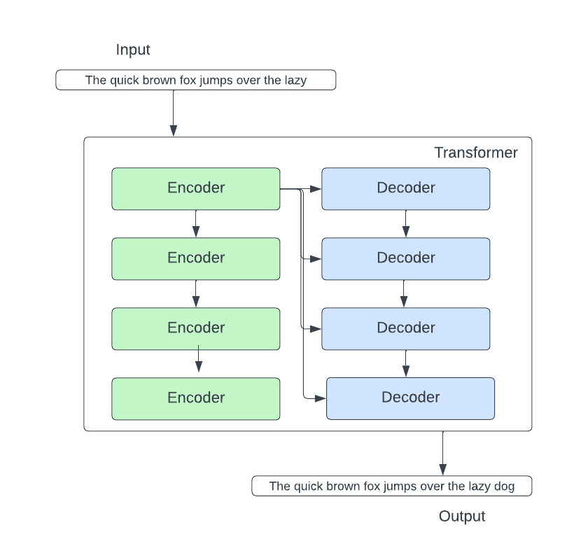

Transformer

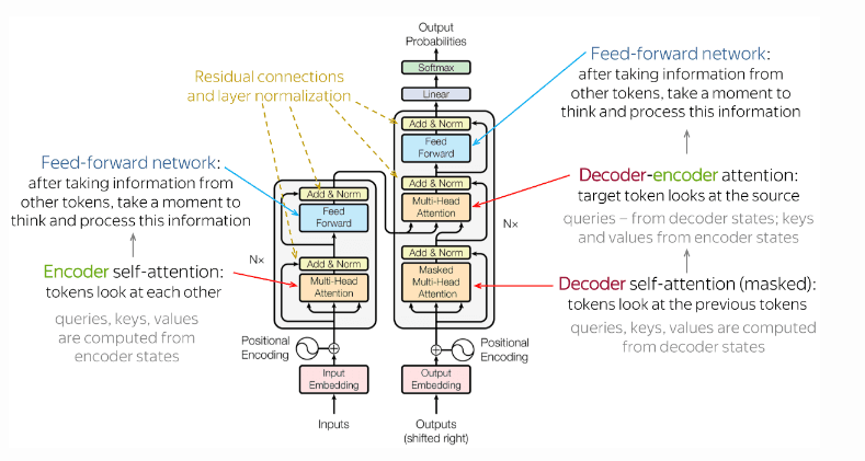

A transformer model is a neural network that learns context or meaning by tracking relationships in sequential data like the words in this sentence. In its simplest form, a transformer will take an input and predict an output. Within the transformer, there is an encoder stack and a decoder stack.
input output

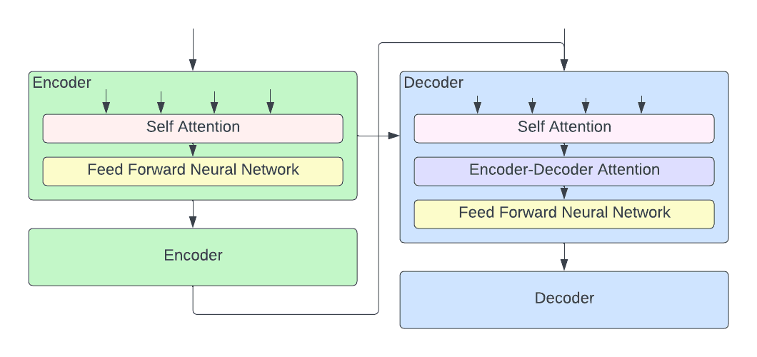

Let’s dig into the encoder block and the decoder block. In the encoder block, there are two important components: the self-attention neural network and the feed-forward neural network.
neural networks
The self-attention layer is crucial as it builds in the “understanding” of the current token from the previous words that are relevant to the current one. For example, “it” refers to the chicken in “the chicken crossed the road because it wants to know what the jokes are all about.”
The other important layer in an encoder is the feed-forward neural network (FFNN). FFNN predicts what word comes after the current token.
Moving on to the decoder side, the encoder-decoder attention layer stands out. The encoder-decoder layer focuses on relevant parts of the input sentence, taking into account the layer below it and the output of the encoder stack.

We will take an input, tokenize the input, and obtain token IDs of the tokens before converting them into embeddings for each token. From there, we will pass the embeddings into a transformer block. At the end of the process, the transformer will predict a series of output tokens. The following image provides a detailed look at the transformer model.
second transformer model
The decoder stack outputs a vector of floats. The linear layer projects the vector of floats produced by the stack of decoders into a larger vector called a logits vector. If the model has a 10,000-word vocabulary, then the linear layer maps the decoder output onto a 10,000 cell vector. The softmax layer turns those scores from the logit vector into probabilities — all positive — and adding up to 100%. The cell with the highest probability is chosen, and the word associated with it is produced as the output for this step.

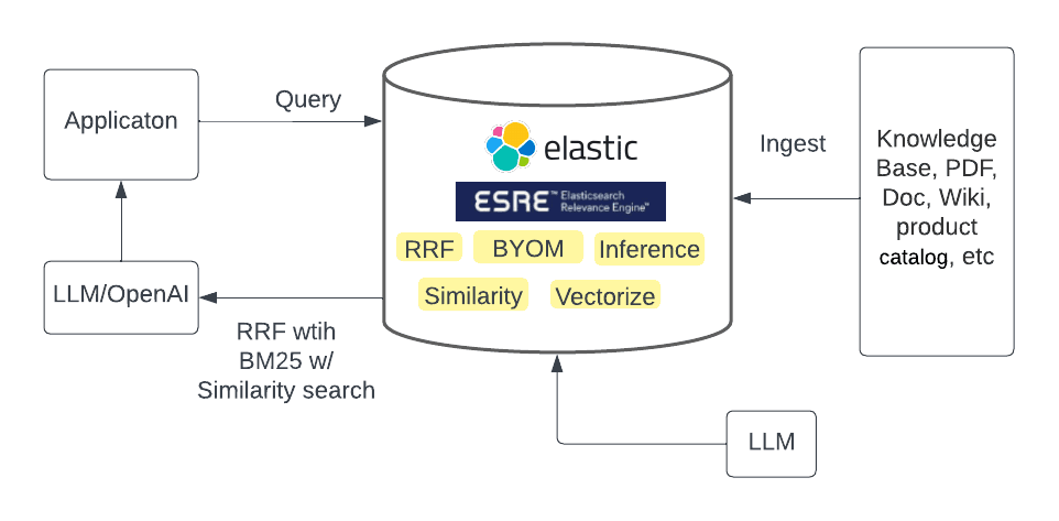

Elasticsearch can be used as a vector database, and to perform hybrid retrieval across text and vector data. There are three patterns where Elasticsearch can provide clear benefits when used with LLMs:
  1. Provide context to your data and integrate with ChatGPT or other LLMs
  2. Enable you to bring your own model (any 3rd party model)
  3. Use the built-in Elastic Learned Sparse Encoder model

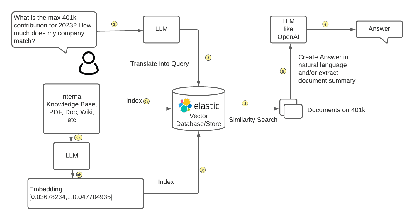

The following depicts how to separate LLMs from your data while integrating with generative AI.
Using Elasticsearch as a vector store and integrate with LLM
A customer can bring their own embedding generated by a LLM and ingest their data along with the embedding into Elasticsearch. Then, the customer can take the similarity search results from their own data stored in Elasticsearch (context to the user’s question) to ChatGPT or another LLM to construct natural-language based answers to their users.
Also, the newly released reciprocal rank fusion (RRF) allows users to perform hybrid search, which can combine and rank search results. For instance, the BM25 method can filter for the relevant documents along with vector search to provide the best documents. With RRF, customers can achieve best search results natively through Elasticsearch instead of through their own applications, which greatly reduces complexity and maintenance of their applications.

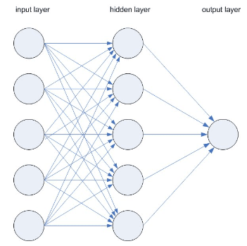

Neural Network (NN)
neural networks chart
Each node is a neuron. Think of each individual node as its own linear regression model, composed of input data, weights, a bias (or threshold), and an output. The math representation may look like:
∑wixi + bias = w1x1 + w2x2 + w3x3 + bias
output = f(x) = 1 if ∑w1x1 + b>= 0; 0 if ∑w1x1 + b < 0
Once an input layer is determined, weights (w) are assigned. These weights help determine the importance of any given variable with larger ones contributing more significantly to the output compared to other inputs. All inputs are then multiplied by their respective weights and then summed. Afterward, the output is passed through an activation function, which determines the output. If that output exceeds a given threshold, it activates the node and passes data to the next layer in the network. This results in the output of one node becoming the input of the next node. This process of passing data from one layer to the next layer is a feed-forward network. This is just one type of NNs.
